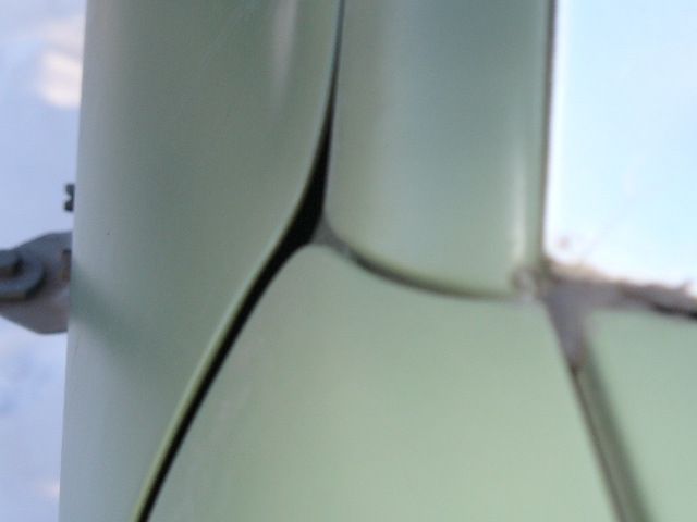

Well I found the source of the leak......the calk on the body seam is split. I removed the ebrake bracket and there it is split! I also removed the small cover under the hood and I think I can put some calk on my finger and get to it. Now what's the best stuff to use to seal this up?
Seam sealer would be best but you may have to get it from an auto body supply place. Good silicone would work too if you can't locate seam sealer. At least you found the leak!
Well I bought a tube of 3m seam sealer from painter supply for $18. I got it all sealed up. The main source of the leak was right behind that little black cover under the hood driver side. Ford used some kind of black foam sealent that wasent applied very well. I'll let it dry nice and good and put the hose to it.
