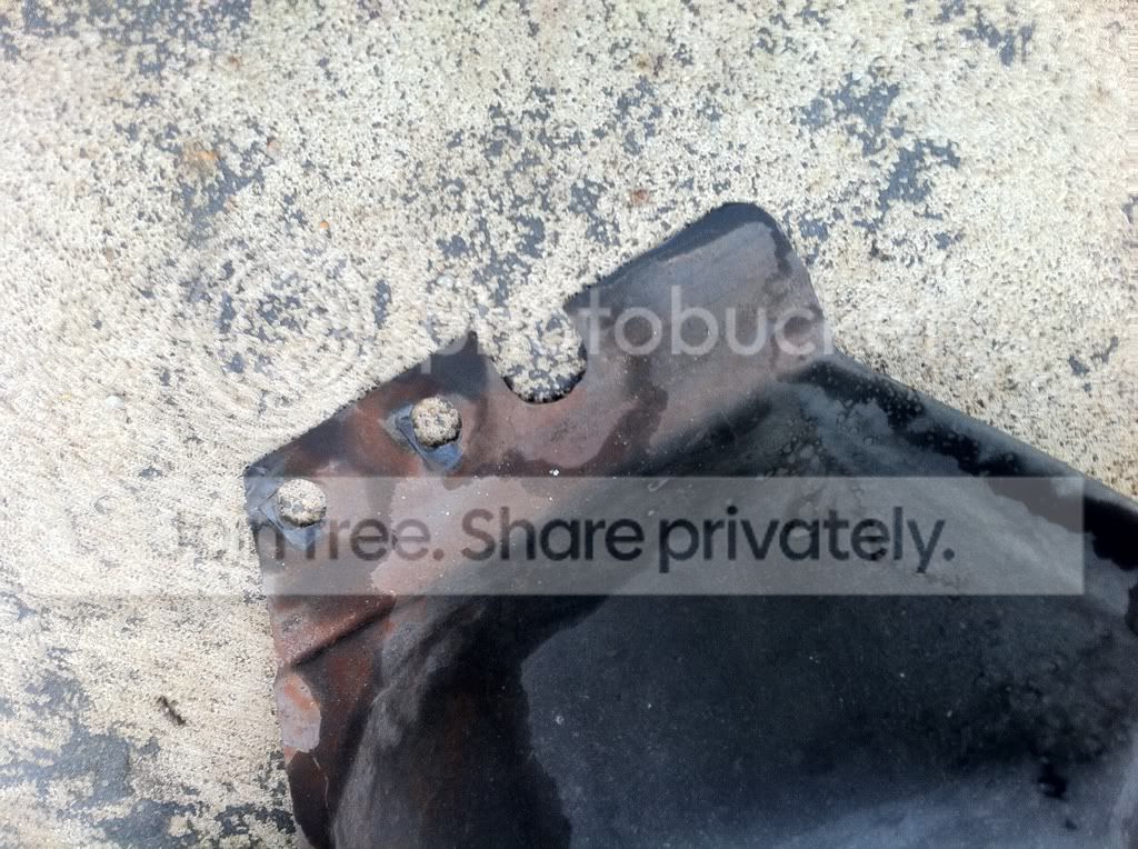

Alright, I know this is going to be a stupid question, but just bear with me. I swapped my transmission in my 98' about over a year ago. In the process, I had to remove both front inner splash shields to gain access. I bought some new ones of eBay, and I honestly forgot how the bolted up to the lip of the fenders. I removed all of the hardware because of rust, so if any of you guys could, send me a PM or e-mail me at ShiftRacing@YMail.Com and let me know or send some pictures of your wheel well. Thanks guys.

I'd drill a series of 1/8" holes along the cracked edges and stitch that back together with some wire (make X's), cause I AM a total cheapskate.
I can't imagine what would be different between a Mazda and a Ranger, same year.
LOL, if it was all there, I would. The problem is, a lot is missing, and the PO already tried that. Of course, this is the same PO that installed a timing belt with the cam 5-6 teeth advanced, and the CMP ~120* off....
I'm probably going to order the cheaper one. Even if it doesn't quite fit 100% right, it's GOTTA be better than the fit of the current one.
