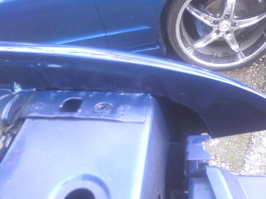

I have a 94 Ranger ,but the entire front body material is 2003. Its said that you need to swap out the core support ,but its not actually true. You can trim the fenders & use hood pin kits for securing the hood. Only the back fender hole in the engine compartment lines up with the 93-97 inner fender hole so the remaining bolt holes towards the front will need to be marked & drilled. Heres the area of fenders that need to be trimmed.

I will post more pics in the next few days as The core support head light area needs to be opened up more for the bulb configuration & a hole drilled for one of the headlamps alignment pins.
