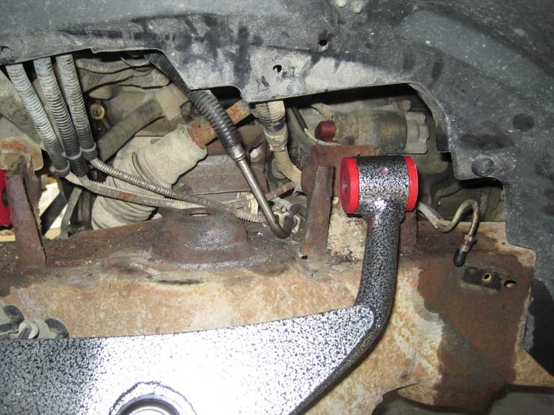

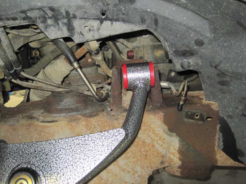

Upon trying to install the upper arms, I have noticed two things. First is that the arms are (measured) 1/4" wider at the bushing end than the factories. In the included pictures, one bushing is in place. As you can see, the other one will not line up without a lot of force...and I can't see that polyurethane bushing lasting very long with this much misalignment. I tried both arms and both are wider than the factory mounts. The original upper control arm slides in an out of the frame without interference.
The second issue is I do not see a c-clip in the balljoint, yet I see a place for a c-clip. I am assuming there should be a c-clip installed here, yet there is not? The lowers have a c-clip installed. I have not test fitted the lowers yet...a bit afraid too.
Did I just get a bad set of arms, or are they suppose to be wider? To say the least, this is a bit disheartening.

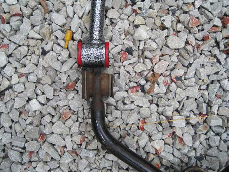

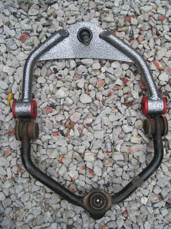

Just adding a couple more pics for your viewing pleasure. I really can't see this being the design. In both of these pictures, the arms are lined up at one end showing the width difference at the other.

where did you get the kit form? Those don't look like Ranger arms to me....
Brian from Illusive Design and Fabrications.
The lower arms are the correct distance apart. Don't know about the rest.
Having a machinist background, I find it amazing that those arms are off more than 1/16th inch....(welding distortion)
let's hope somebody put the wrong arms in the right box & they''ll correct the problem for you in a hurry!!!!!!!!!!!!!!!!
Definitely give the dealer a call about it and they should exchange them for you, also call DJM and see what they say, at least this way they will know that they had a bad batch of arms come out and they may do a direct exchange and pay for shipping both ways. I have seen a couple guys come out that way where it only cost them a day or two in down time. Worth a call!

Yes, I did get it solved with much bickering. It turns out that DJM changed their design about the time I bought my lowering kit. They made the arms wider (as you can see in the pics), but installed a much thinner bushing to make up for the difference. The arms shipped to me had the original, equal thickness bushings installed causing the problems. DJM shipped me the new, extra thin bushings, I pressed them in, and we were good to go. The truck was down for about a month waiting on someone to admit fault. DJM was not overly helpful and did not impress me with their customer service. About 5 years ago I bought a drop kit for my F150 that I still haven't installed from DJM. It scares me a bit after this mess.
