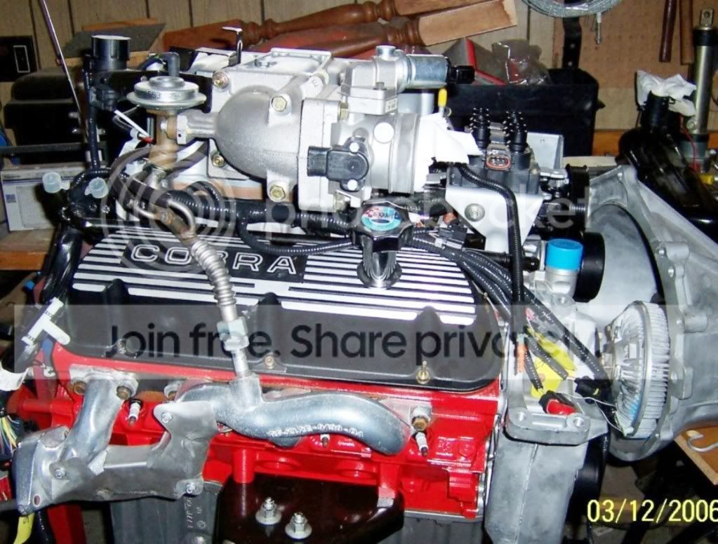

what has everyone used for exhaust manifolds on a 5.0 in a 98 or newer ranger? what kind of clearence issues did you have? any headers thatll work?
As far I've seen, the only three that work in the chassis are the stock Explorer ones (tube or cast iron ones), the discontinued FRPP ones and the ones from Torque Monster Headers. They were for the most part designed to fit the GT40 "P" heads with their unique spark plug angle, comes straight out. Use with standard heads and you'll be burning plug wires unless you go with short boots and 90 deg wiring. I posted that picture of the drivers side on your other thread about mount/oil filter. You can see there how the exhaust port exit upwards for clearance, same goes on passenger side. Think someone was able to use the Tri-Y's but can't find that info now. Maybe someone else can jump in with better info. Bob at Torque Monster will build the headers to suit what suspension, year of chassis and type of heads you have but run about $780.
The Torque Monsters have a similar construction on both sides.
