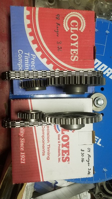

The 98 chain and gears are actually wider vs the 01 chain and gears. Earlier had 11 bars in each link, later only has 9 bars in each link. I took some side by side comparsion photos. I actually just finish up the swap today. Drove it around today for the first time. Took my time did eveything right, only a couple of issues. Had to change the fuel pump out as it went bad sitting up for 3 years (was like this when i bought the truck) and one of the injectors was clogged up. I took it out and i had it cycling on the bench but it wasnt flowing anything through it. I tried to back flush, forward flush, side flush, upside down flush it but no go. I had a good spare injector i replaced it with. I think this is going to be a good runner. Next one is an 04 ranger edge extended cab step side. Bad 3.0l in it as well. I already pulled the heads, they were toast. I purchased a rebuild set of heads with all hardened exhaust seats installed. Now to pull the rest of the short block out and freshen it back up with new rings and bearings.
Comparison between early and later chains n gears.
