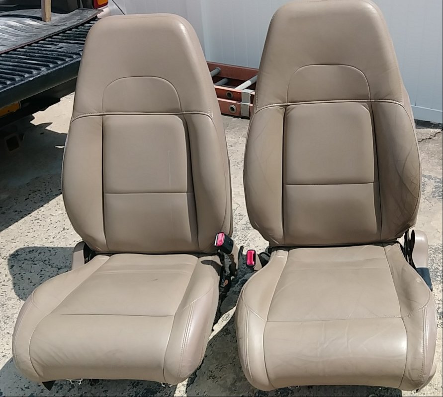

think of it from the manufacturing standpoint,you don't really think every model vehicle has a unique bolt pattern just for itself? I recently picked up a pair of all electric leather seats from a 2000 Explorer, I have a discussion going on it, my truck has bucket seats from what I understand the mounting holes are there, just need to be threaded when you change from the 60/40,. https://www.therangerstation.com/forums/index.php?threads/2000-explorer-seats-fit.181666/
28174
this is one of the seat brackets. the front holes do match up, but the rear ones do not at all. Almost any ford buckets will fit all the tracks. its just "Which tracks fit your truck?"

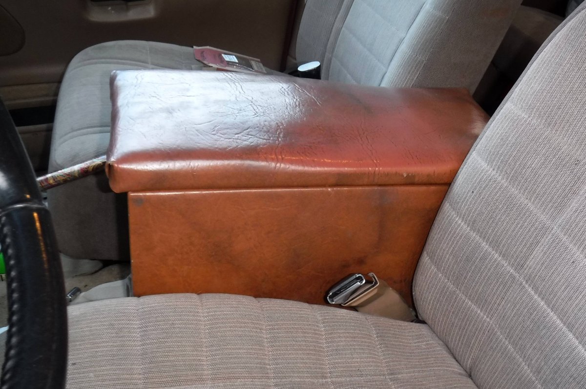

There's a homemade box console in my 96 Explorer. It has a leather-like vinyl all around, padded on the top, which is also a good height for an armrest. The top folds up and over with some string to stop it from going plum over(which needs to be adjusted).
It works fairly well, has much more storage space, and is fairly comfortable too.
Even after yanking a console W/folding armrest from PicNpay I'm yet to much consider replacing it
