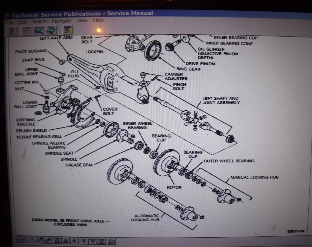

Actually the hubs aren't electric, the Transfer Case switch is. The manual case switches using a seperate shift lever, the electric uses a button on the dash to move a so
lenoid sized switch on the transfer case, simply off>4xH>4xL
The simple movement of the forward drive shaft is what actually engages the electric shift ( I should say the electric shift "whatchamacallit" :D ) Fact is I'm rather lost to describe this very well myself atm, because if your front axle is completely off the ground and on stands, you can turn the front drive axle forward of the transfer case, turn it in either direction, having pushed no buttons or anything, and FWD begins locking in
Dealer should be able to get a new door sticker, they are available because sometimes they get destroyed.
Auto front hubs have a nasty tendency to not work right when you need them the most. They’re not electric, just a sort of spring loaded gear crap. Easy to change over to manual which are far more reliable. Down side to manual hubs is you have to get out to lock or unlock them. Usually unless I’m doing highway driving or something, once the snow starts coming regularly I lock the hubs in and leave them like that all winter. Lose a little fuel economy turning the front all the time but then when I’m losing traction I can just hit the button or pull the lever for the transfer case and don’t have to stop and get out. You can also engage the 4x4 without locking manual hubs, I’ll do it when I want low range but don’t need the front axle, like moving a trailer around in tight quarters. I don’t need 4x4 but just about having to give it gas to move anywhere and moving easily at the speed of a snail is handy.
You do have to be stopped to get into 4-low, with an auto transmission you have to be stopped and the transmission in neutral, not park. Same to get out of 4-low. 4x4 high and 4x2 high (2wd) can be switched pretty much anytime, driving or not. Think they recommend 45 mph or less for switching.
You have to back up 10 ft in a straight line after you disengage 4x4 to release the front hubs. That's what my owner manual says.

Junkyard hubs are the easy way to go... you need both wheel bearing nuts and the keyed washer that goes between them too. You will also need two specialty sockets to remove the auto hub bearing nut and another to reinstall the manual bearing nuts. While you're in there replacing that stuff, it is a great time to pull it all apart down to the knuckle and re-grease everything and make sure the spindle bearing, wiper and wheel bearings/seal are all in good shape.

You don't need a special socket to get the auto hub nuts off, just a magnet (for the key) and a big pair of channel lock pliers... You do need a D44 hub nut socket to get the manual hub locknuts off and on though... I've made do with dumb things in the junkyard but the right tool is highly recommended... The stock manual hubs are fine, they're Warn, there's higher rated ones but anything new is a fair amount of change...

@Josh B You were saying the hubs aren't electric, (which answers my question wouldn't I have wiring) but the forward movement of the drive shaft engages the hubs. If I got that right.
So then it makes sense that my manual says when I turn off 4x4 I need to back up in a straight line 10' or more that will dis-engage the hubs. Right?
They call them "Automatic" (says on the hub) but really, it's not totally auto.
