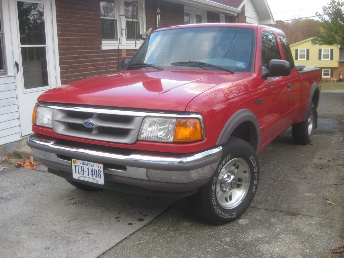

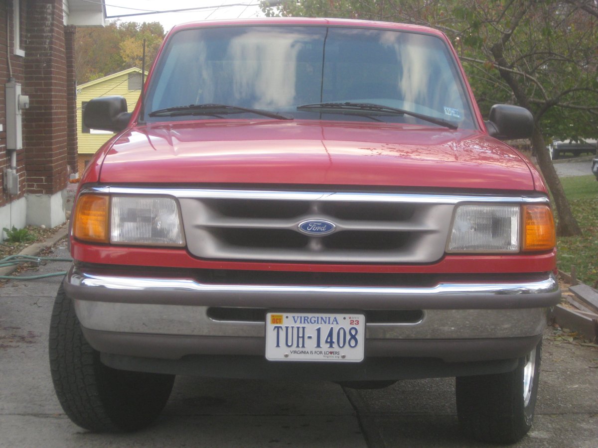

Here's a couple pics - not horrible for 25 years old! Wiped some of the bugs off the chrome otherwise didn't even wash it yet.

The frame horns is the portion of the frame where the bumper brackets attach.
My recovery loops are attached so they poke through the center hole in the bumper. There isn't a lot of clearance but there shouldn't be much strap movement at that point either.
They are located on either side of the license plate bracket in these pictures.
The bumper on the 1998 model is more similar to the 1997. The loops or hooks would be mounted about similarly as the 2011. The lower valence got ripped off due to damage done to it. It hung down about the same as the 2011. If I remember correctly, the valence on the 4X4 models don't reach down so far.
