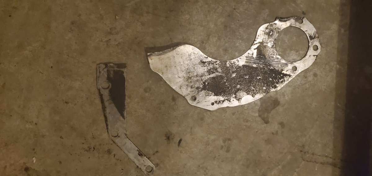

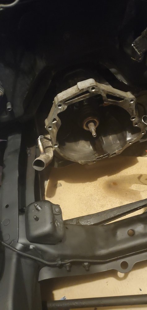

I have a 1997 ford ranger 3.0 with a 5 speed and I need the metal plate thats sandwiched in between engine and transmission i think its called a starter index plate but im not sure. I need to know where I can get one ASAP. Is it a dealer item? Also I know the power steering pulley was put on backwards it was a Honest mistake already fixed tho.

Here's some places that have a 3.0 engine in Missouri. I see a couple core engines, which would be perfect place to get the plate.

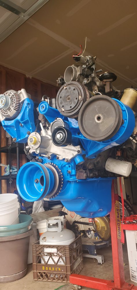

Junkyards would be the best place to get that part. I am liking that blue. Did you have your 3.0 rebuilt?
I did it all by myself....besides the powdercoating... i took all my parts to gateway powdercoating. The original motor blew up at 260k miles and this motor is out of a 1998 mercury sable with 100k miles, Did all my research and had all new parts put on. New motor has ported and polished heads new valves and springs and ported upper and lower intake and has a mustang 60mm throttle body on it along with a 2000 ford taurus intake manifold. Basically everything is upgraded and better. It will be getting alot more air for sure. Im also doing the electric fan swap from a 2010 chrysler town and country van. I am really pumped to see what my new set up will do.
Thanks I really appreciate it. I have alot of pictures already I will add them all together somehow and show you guys as soon as i get the truck finished. Here within the next couple weeks.
I've been driving it for the past week and put 250 miles on it. Its running lean and I really need a small tune any suggestions?
Yeah same here. That was my goal lol I have to clear the lean code for it to run good every time. How else can I add more fuel then? Bigger injectors now or what?
