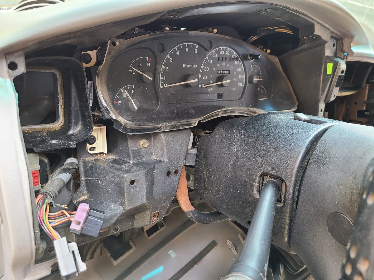

1997 headlight/fog light wiring below
Fog light switch on lower left, shows a 6 pin plug but only 4 wires
Thanks- I have a schematic, just haven't been able to find the physical wires on the truck

Does your headlight switch have a setting for foglights? Or did you have a separate switch? I have neither, and I thought I'd read that the XLT should.
Mine had a separate switch. My 97 F150, however, had it built into the headlight switch. Rotating the switch to the "on" position allows me to pull the knob out for fog lights. I had trouble figuring that out for some reason. So I put my own separate switch in the dash on the F150.
I believe some design elements of the dash changed around 96 or 97. So I would expect your dash to be different from my 93.
Ok, yeah I haven't located any wiring in the dash or around the radio either, so im just going to setup an isolated circuit, thanks
