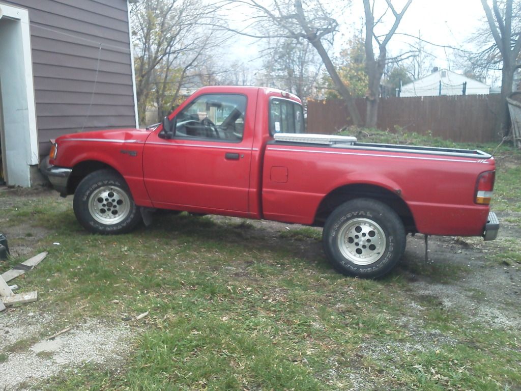

I suck at math. I am wondering if my '96 2wd 2.3L 5speed will be ok pulling a 6x10 enclosed trailer with a race kart some spare parts, tools, and a small generator. The axle code is "86" , front GAWR 2150, GVWR 4220, rear GAWR 2384 (from the door lable)
on the trailer the tag says GAWR 3500
Weights are in lbs
I live in northern ohio and the ground is very flat, overpasses are the biggest hills I go over to get to the tracks.
Any ideas? BTW tires are 235 75 15

The truck

I doubt the weight will be much of an issue. The aero drag, on the other hand, may make 5th gear rather useless.

Keep her to 55-60 tops and stay in 4th. It'll do it.
If you're expecting to keep this setup for a while I'd stick some 4.56 gears in that rear axle. That's the same setup I have and it's rather disgusting how well it works. Believe it or not my mileage has increased.
wind resistance with a box trailer is the worst thing you'll have to deal with (and stopping quickly) i have a similar trailer, even with the 4.0 V6, 5th gear isnt useable. my non-towing milage is 17-19, milage while towing is 10-12. my gearing is 3.73's with 235/15 tires. any hills you encounter will probly have you grabbing 3rd gear & holding it to the floor. regearing would help. id do mine but i dont tow very often & id have 2 to spend money on (since mine is a 4wd)
The V nose on the trailer may help, but that thing is going to be like pulling a sail the whole time. Back when I had my 2.3 Ranger I used to use the car trailer when I had to haul something, it pulled way easier than my 6x10 enclosed even though it was twice as heavy.
With my trailer, 6x10 flat nose, I wasn't going over 45 much unless I was floored in 3rd. That's with 3.08 gears though, yours may be better.
Your big issue with that is going to be those oversize tires you got on your truck. Agreed, either get some 4.56 gears for the rearend or put the stock size tires back on (probably be be either 195/75R14 or 215/75R14... should be listed on your door sticker). I'd do the 4.56 gears.
