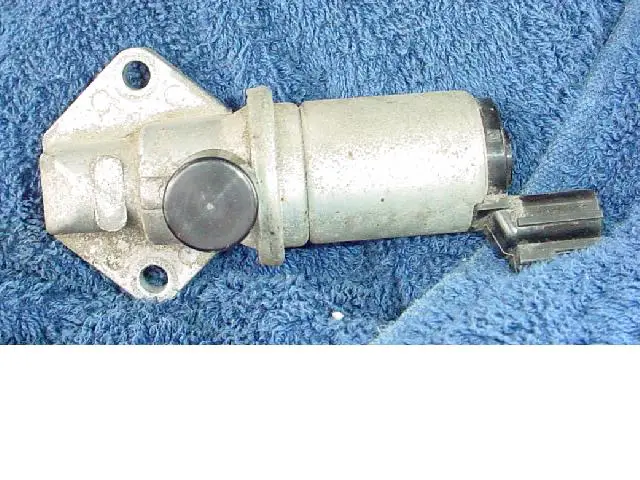

Your IAC (Idle Air Control Valve) is sticking. It's located by the throttle body & intake manifold. Take it off the two 10mm bolts, spray it very thoroughly with carb cleaner, and replace. The 3rd Gens are notorious for this.

I took off the valve and it was black! I cleaned it a bit but the seal seemed funny. I went to Autozone and bought a new one for $40 and put it on. So far it seems to have done the trick! I turned it on and off several times without a problem. I will check back with you in a week or so. Thanks again you really know what your talking about!:icon_cheers:
