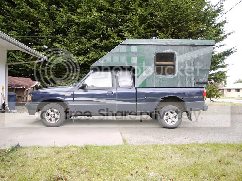

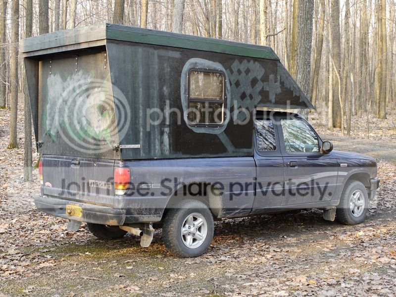

So I built the shell in NY, 3/8" cdx plywood, 1x2 white pine studs, high grade polyurethane construction adhesive, and exterior grade star screw. I predrilled everything through the plywood. I used flat 2x4's for triangulation braces so the leading edge and the top edge of the thing, the part that hits the 80mph wind, is solid as a rock. The leading edge and the top edge of the roof both have double 2x4 headers going across, glued and screwed.
On top of the plywood I put two coats of epoxy resin, and I used fiberglass cloth on all joints and corners and edges. That made it waterproof. Then I put two coats of Above Water Line marine paint on top of the resin, and did it in a sort of artsy fartsy way. Some of it looks stupid, like the hatch marks that are supposed to be a weave? And the first aid cross. Goofy. But the rest of it is okay.

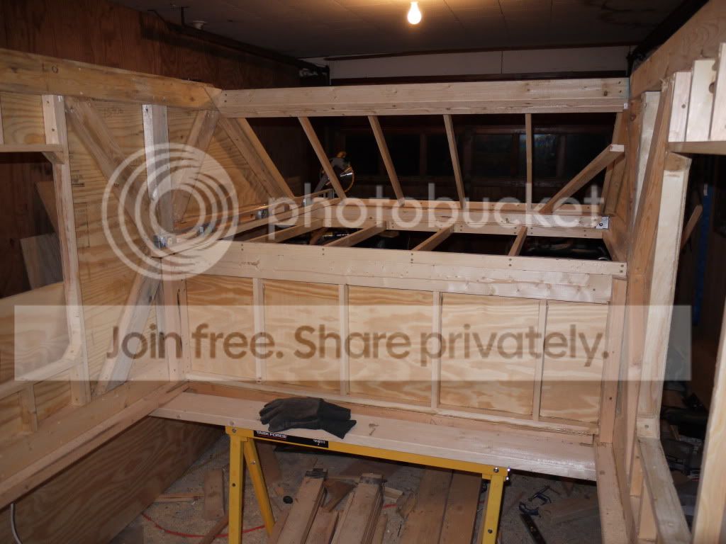

So on the inside there are three layers. I have three 2' x 5' panels that join up with the floor of the overcab to make one long flat floor from front to back. It's about 8'6" x 5' 0". I had my queen mattress up there, but gave it to someone. Now i use a foam pad.
I'm going to build some cabinets along the two sides and the front of the bed, that will double as short tables and a couch seat. The back corner will have a space for my twig-burning cook stove, and I'll have an exhaust hood installed right over it, attached to the framing of the shell. I'm looking for a tiny woodstove for it, but will set it up for both the open fire cook stove, and if I find a woodstove, it's pipe will fit right up in there.
Anyway, I've been drawing and measuring and drawing and thinking, and I'll probably buy the materials to do it tomorrow. I'll be hitting the road about March 13th, maybe sooner, for some exploration, truck camping, backpacking, and plain old camping out! I'll get some pix tomorrow, the before shot - the big empty, showing the three panels that can fit in several places. Like for a table possibly. And I'll figure out how to get a picture on here of my drawings of the layout, cross-section, construction details, etc of the cabinet/seats.
The back end is 3" higher than the front now, because I had the rear leafs retempered, and I added a heavy duty leaf to each side (duh, each side). And i added new shocks in back. The front has not been retempered, and has the worn out shocks, and it sits 3" lower. I wonder how to fix that.

The shell weighs 750, and with the cabinet/seats, I think that will be 850.
