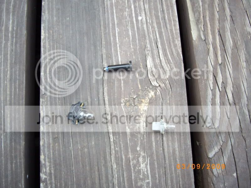

Similar, but alot different....Black one is the headlight, grey one is the 4x4 switch...
(pictured are in-progress shot of LED mod)
