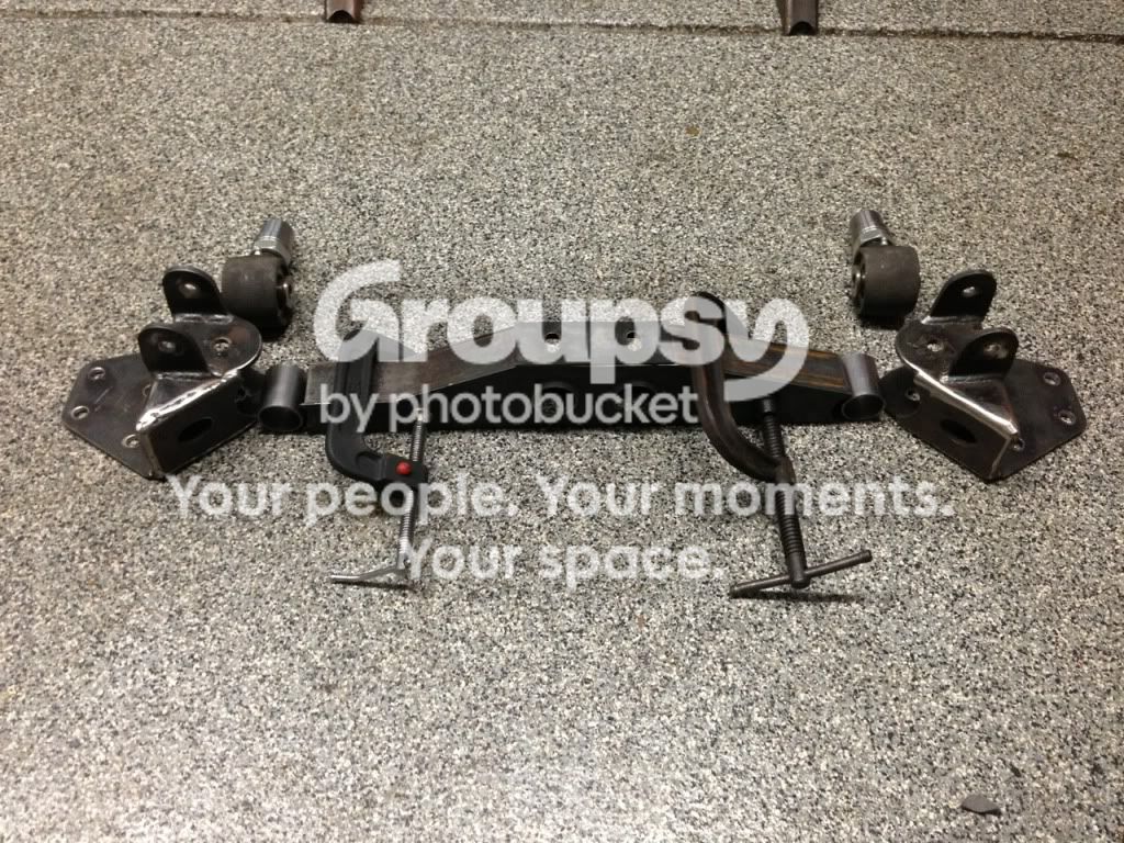

So after realizing I want it bigger I found "Brian1" on explorerforum and had him build me a custom trans crossmember with mounts for a trail gear creeper joint on a set of custom radius arms.

Got the cross member all welded up and installed along with the new radius arm mounts
All I need is leaf spring perches and u-bolts for the rear, brake lines, and a pitman arm so I can get the rest of the lift on
