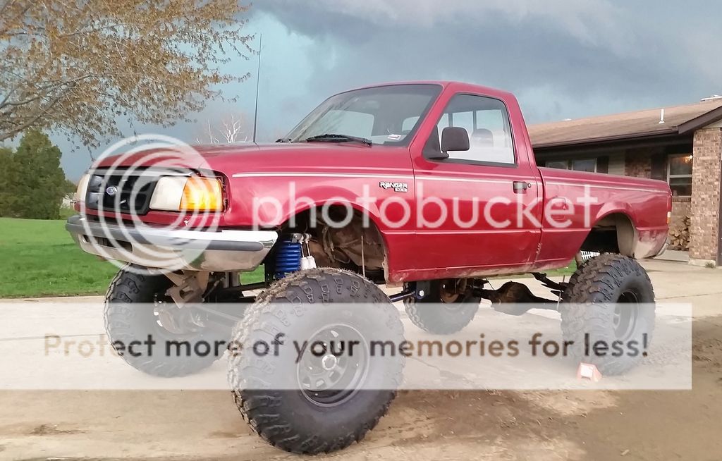

Been getting a little done here and there. Motor , Trans and case are mocked up. Been gathering parts also.

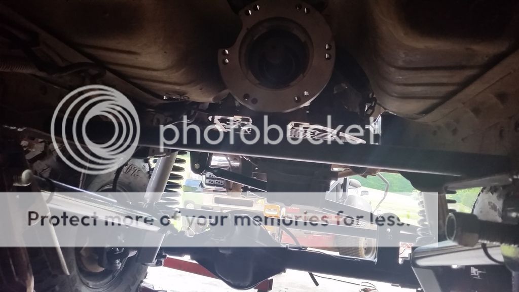

Mines a 6 bolt, and I see the part your talking about but the peice that bolts between the Trans and the case is the difficult part, this is what I ended up getting
[/URL][/IMG]
I like this option of mounting the two together with my short wheelbase.. He used the short 32 spline chevy input in the ford case and shortened the trans output shaft down to match, all with using 1.25" adapter.

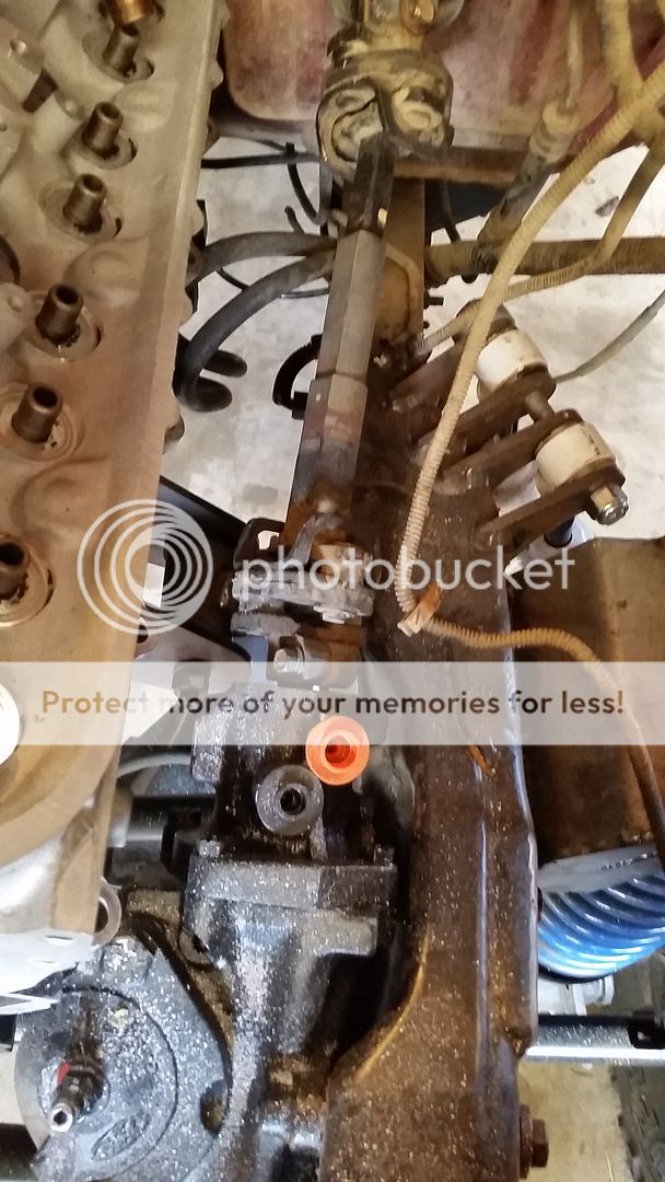

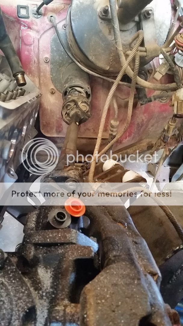

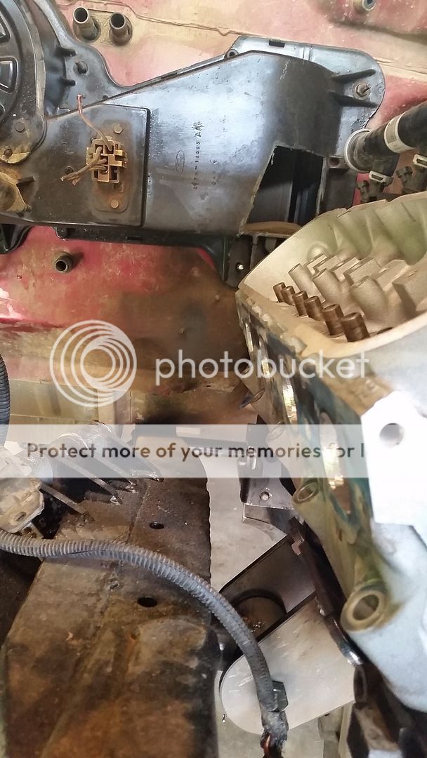

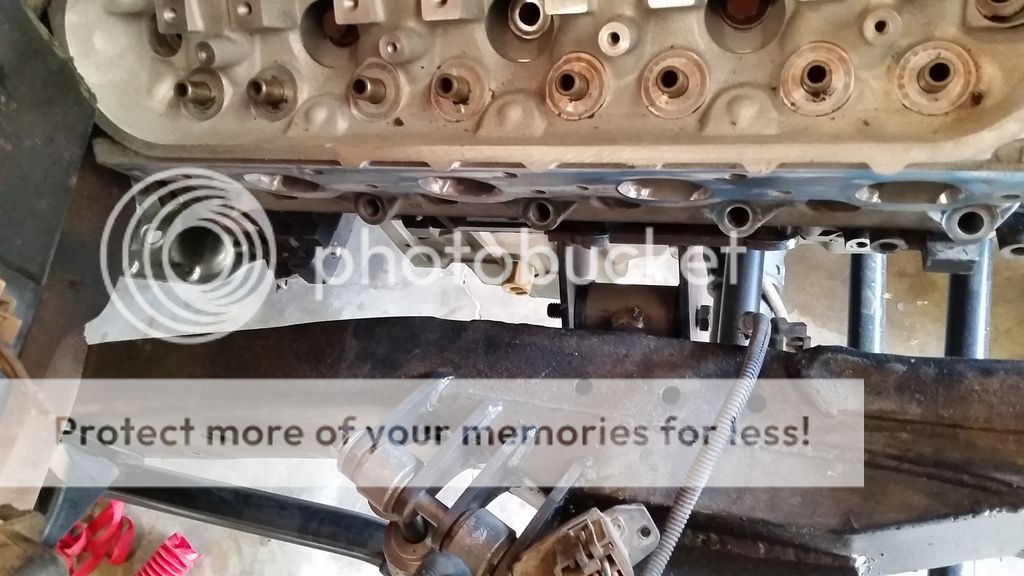

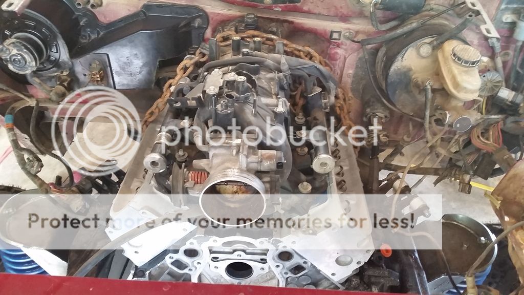

Can you post a few pictures around the sides and the back of the engine? I am curious to see how much room there is for headers/exhaust.
Thanks
Drivers side
Passenger side

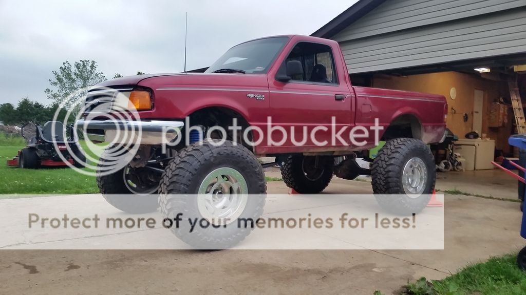

I have a chance to buy these wheels and tires at a decent price, what do you guys think get them or pass
