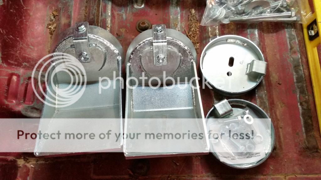

what was the bill for the duff stuff?? just curious?
and what are you planning to do for upper coil buckets?
i need to fix mine I'm still rocking the original bronco 2 buckets.
i was once looking at the duff buckets, but couldn't wrap my brain around the price tag,
looks like really nice stuff tho.
Everything seems over built , if I break this stuff I would hate to see the truck. It's pricey $899 for everything in the pic. I don't know on the buckets yet I have thrown around a few options but they sell a early bronco set that spaces the bucket out for a full size swap and been thinking about that
I used 79 buckets on mine. I built adjustable brackets that I welded to my frame. It was cheap. I know my welds look horrible lol but I hadn't knocked the slag off yet.
I liked Rowdy's idea but got mine from ballistic fab
That's where I got the idea from. If I had a plasma cutter they would have been cleaner looking. I'm dreaming about buying a mill and a plasma table for this kinda stuff then I'd be able to make and sell parts.

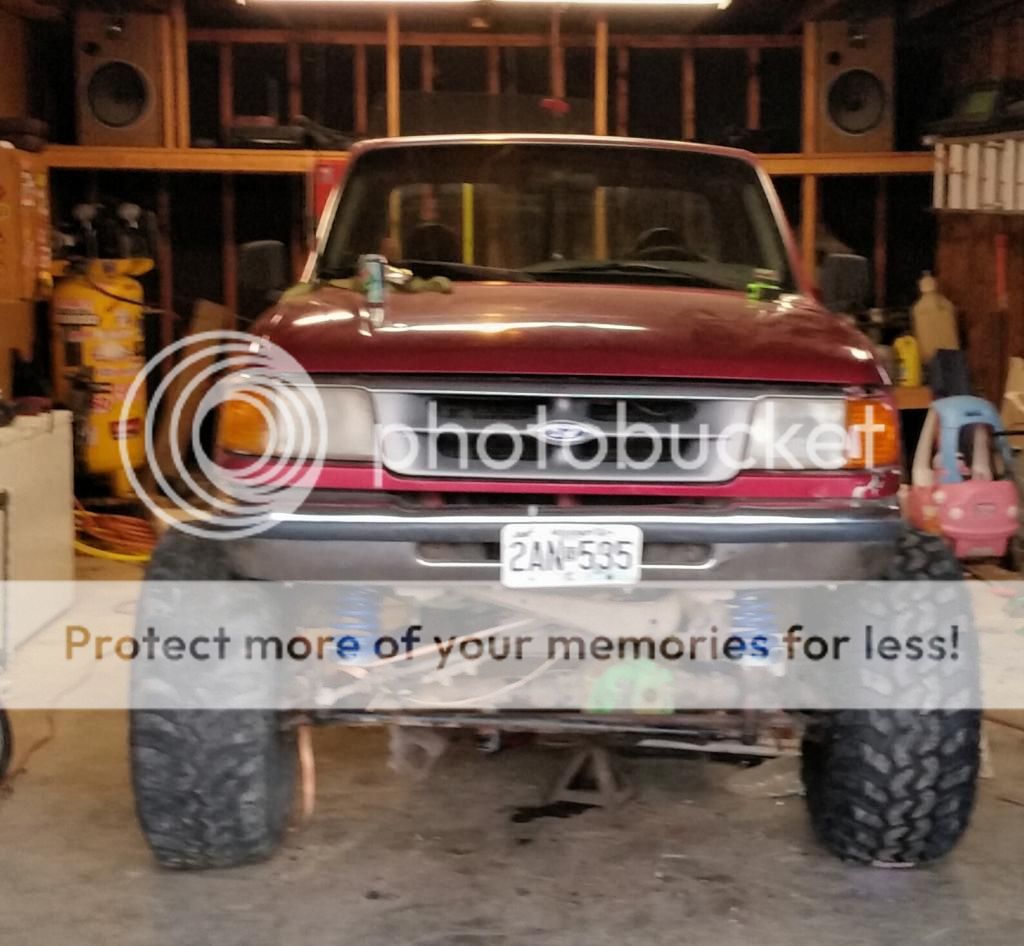

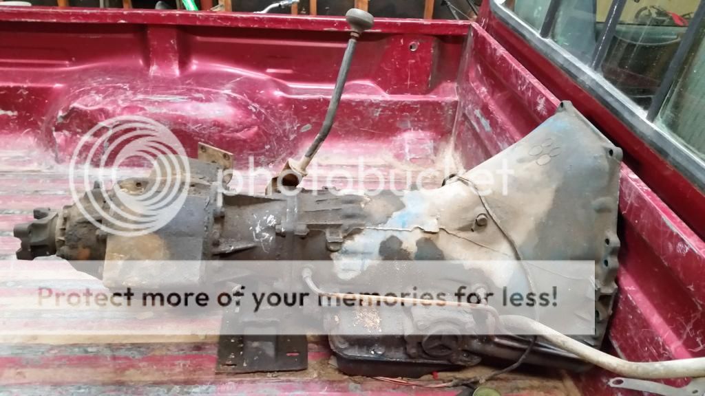

Got some more parts for the ranger, hoping to get to work on it this evening to

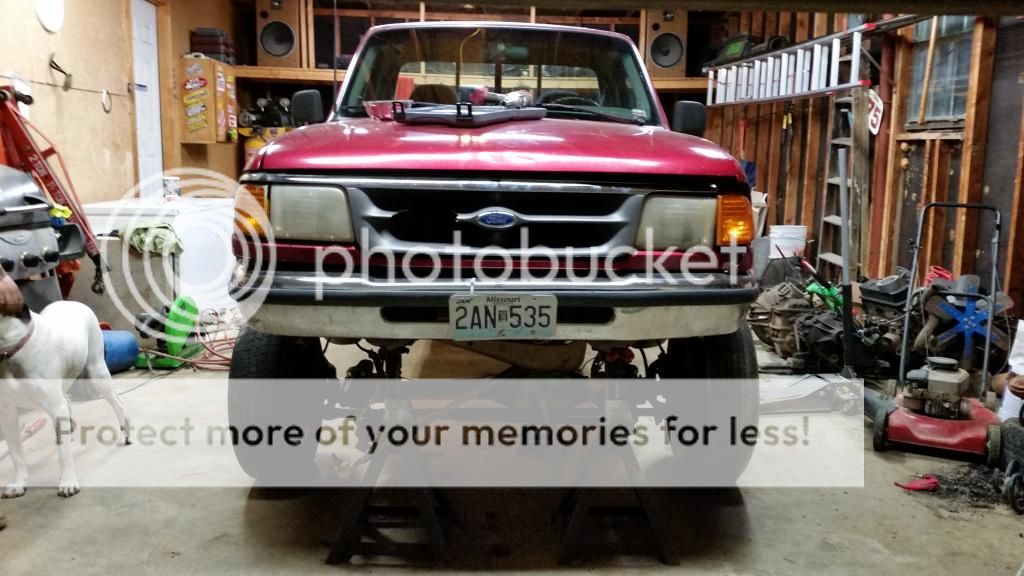

Well this is where I'm at after an 1 1/2 hrs of work last night with a buddies help

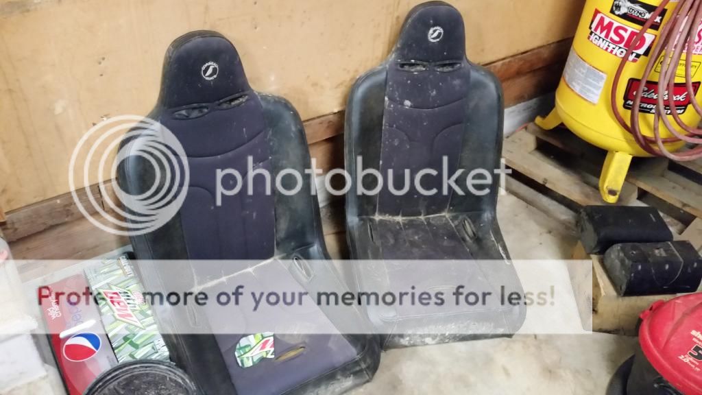

Did some trading with a guy last night, traded an r/c rock crawler for a set of 35/16/15 boggers and these Corbeau seats

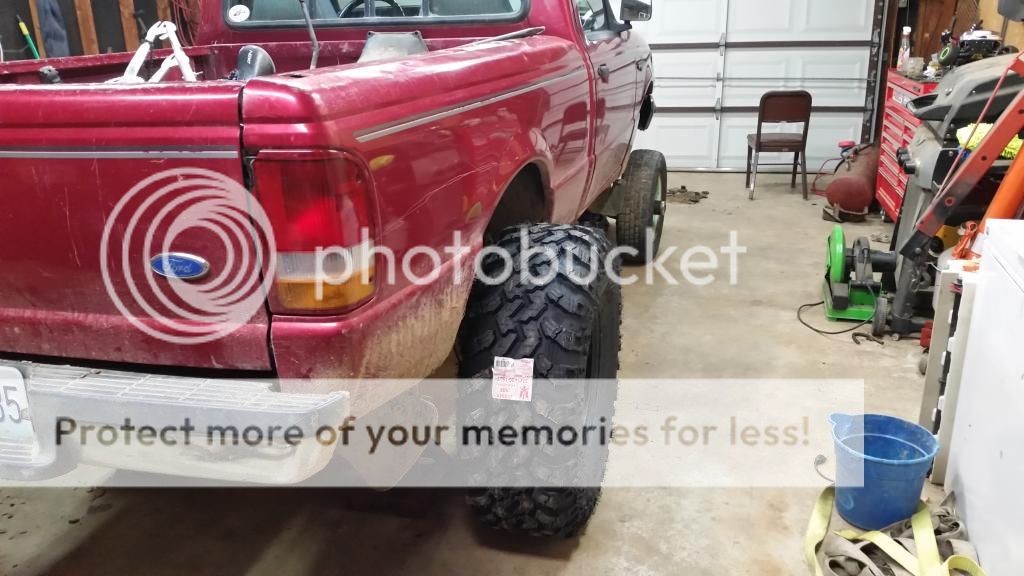

Got some more parts today, hopefully get to work on truck Friday should have a rolling chassis by the weekend
Like he said they are James duff for an early bronco running fullsize axles

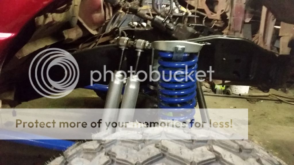

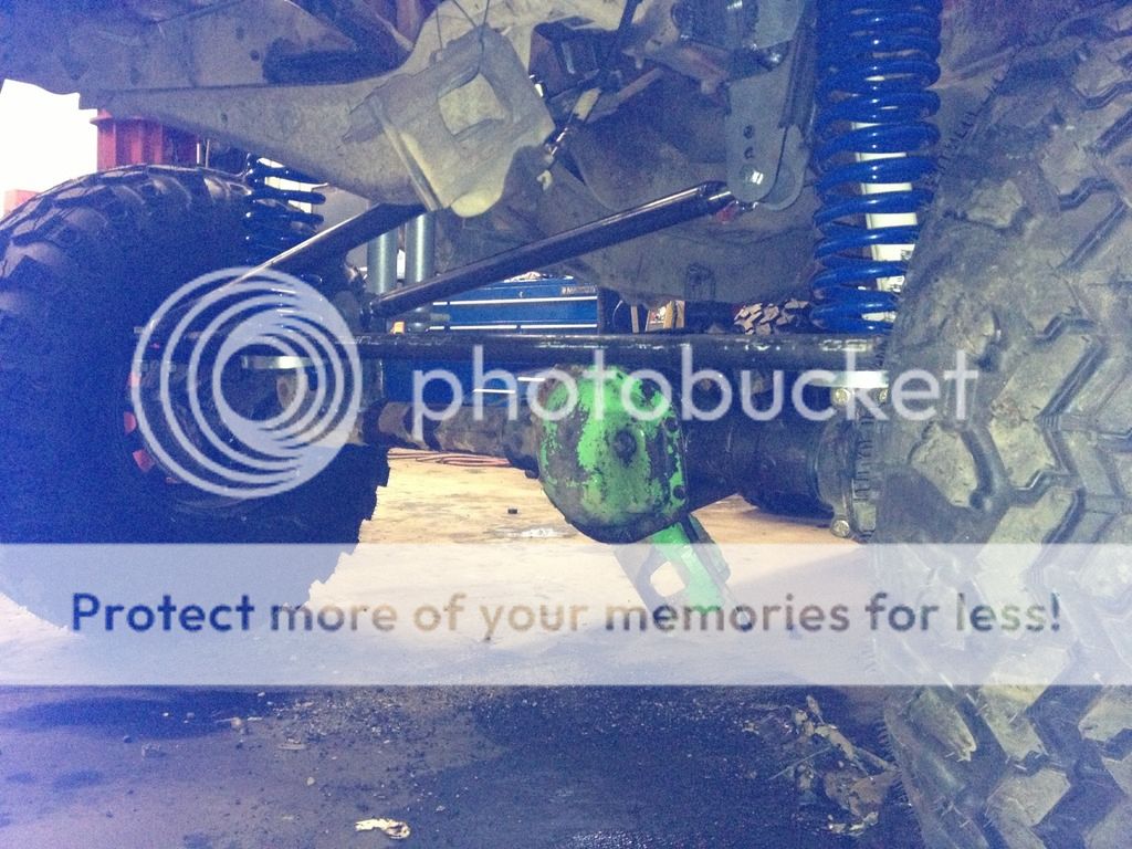

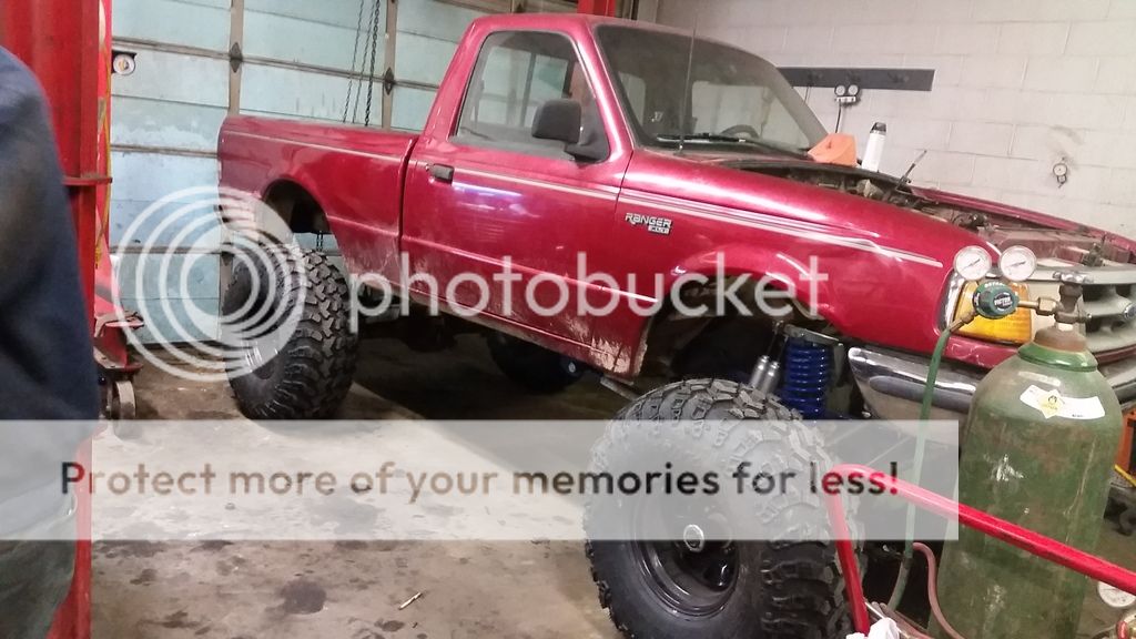

Well got some work done to the truck to answer the question 3/4 ford knuckles now I have to get new ones. My buddy Daniel was home for a week from his job and wanted something to do so he built a ranger. Front suspension is done, cut out the engine crossmember and boxed the frame, steering is mostly done, may get a drop pitman arm. Got my rear springs in wish I would have ordered a bigger spring but we're close now. Also got all the irocs mounted on wheels and put on. Here some pics of progress.
