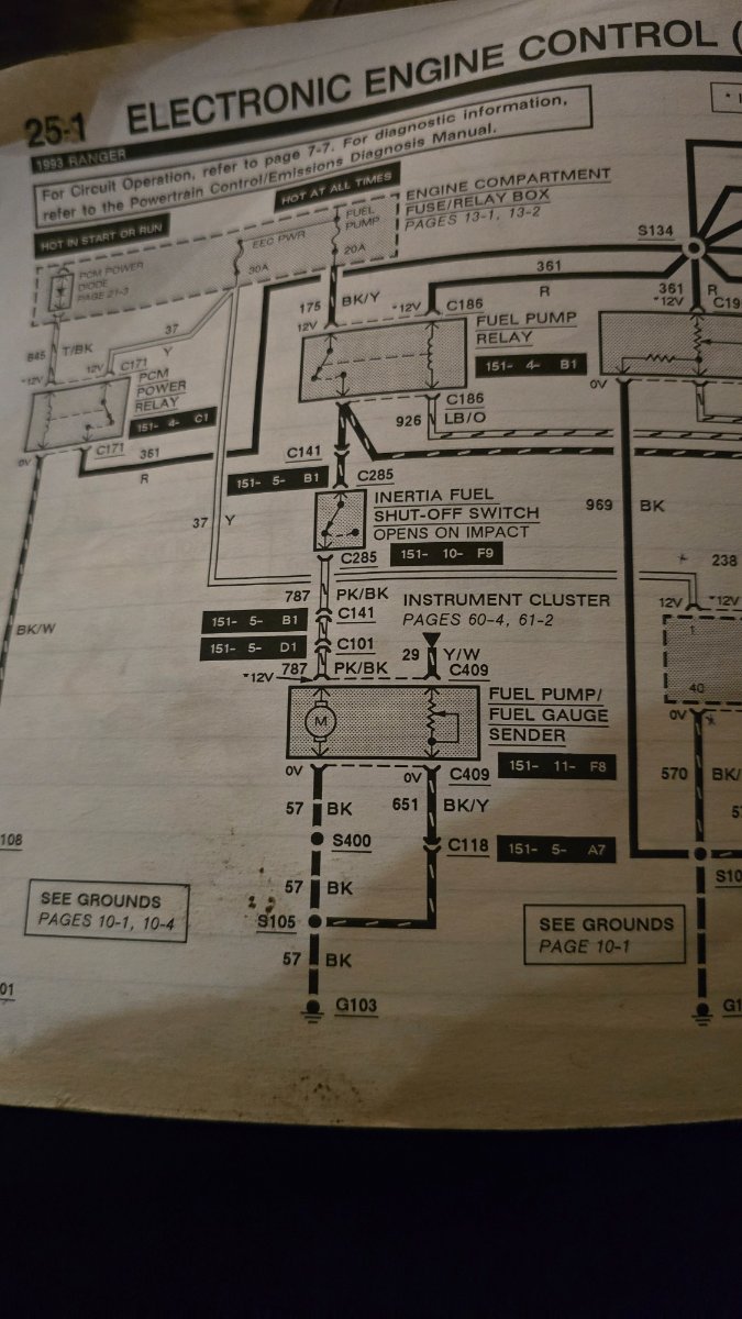

I need a wiring pinout for the 4 pin connector on the fuel pump assembly so I can bench test the pump. I think I have an electrical gremlin causing my fuel pump to not work. On the connector, I measure at Ground (4) and The 2nd wire in and only see 8 volts with the key in the on position, and 5v on the wire next to it (The one next to ground). The battery does have 12.5V on it but it is an older battery.
I don't know which wires are in which pins. But...
Pink/Black wire is power to the pump>Battery voltage
Black wire is ground for the pump
Yellow/White wire is power for the level sender > 5volts
Black/Yellow wire is ground for the level sender
8 Volts means there is a dirty or loose connection somewhere.
With engine OFF the pump only gets voltage for a few secinds when you turn the key on. You will have to jumper across the relay contacts or use the diagnostic connector to get continuous voltage for troubleshooting.
