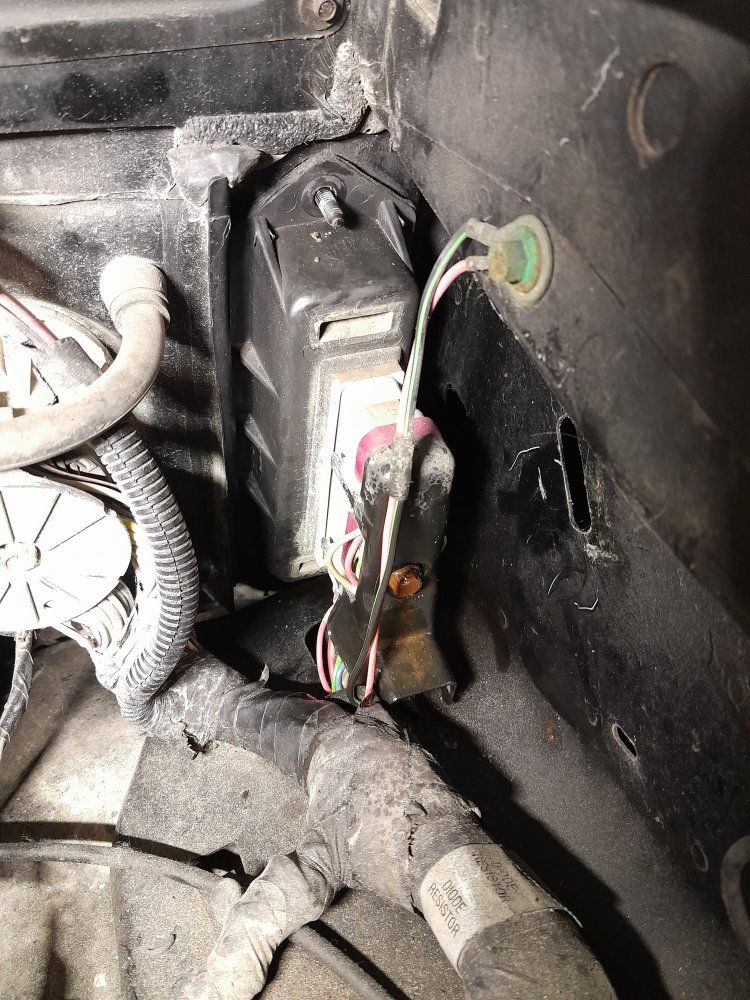

You can pull out the computer and open it up
There are 3 barrel capacitors that can fail/leak which will cause running issues, easy to replace, under $5 fix
This could also cause CEL and odd codes
Like the 3 blue capacitors in this picture: http://www.auto-diagnostics.info/ford_eec_iv
I had to do this on my 1994 a year or so ago
While you're checking the computer, check that the ground wire is not corroded. Even if t looks okay, clean it up anyway. It's an easy job.
Mine was giving me fits for months until I decided to follow Ron's suggestion to pull the computer. On the way to pulling it I corrected the corrosion on the ground and I haven't had a problem since. (crossing my fingers and hoping I didn't jinx it now).
