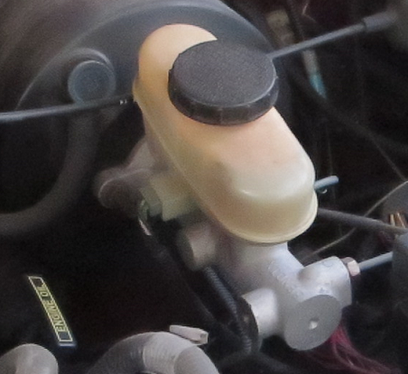

1994 Ranger, 4.0L, auto, factory cruise, 76K miles, extended cab, most factory options. The cruise control system worked for years, then intermittently (on one trip, off the next) for 6 months. Symptoms indicate it is be the master cylinder cutout switch. Pix show all models after '93 have it mounted either on top of, or below, the master cylinder. The next diagnostic step is to jumper across the contacts and see if CC works.
Unfortunately, it seems missing on this truck. Any ideas?

Brake light switch is the cutoff, also clutch switch if manual trans
There is also a vacuum line that runs into the cab to the Booster's atmosphere valve, it releases vacuum in cruise module as backup disconnect when brakes are applied, its called the Vacuum Dump valve
If this was leaking cruise would come on but wouldn't hold speed so would shut off
The wires on Master are for Low Fluid Levels, and cause dash "brake light" to come on and ABS light

I was looking at parts and they list the master cylinder cutout switch, and pix showed it... thus my confusion. I'll check my nephew's '94 Explorer... maybe it was only on those rigs.

1996 and up cruise did have Brake switch AND pressure switch on Master, but not 1994
