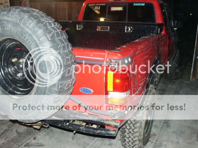

still trying to decide how i plan on mountion the spare . i still want to be able to use the bed but carry a spare and i dont think i will be able to do both. once the ext cab is on this frame i wont have any bedspace to speak of. I kinda wish i could throw it back under the truck since it's at least outta the way there but i dont think it would clear the axle let alone fit between the frame rail's
you could do it the way brayD did his with the swingout carrier, i dunno if this one is his or not but its similar. i think it came off a blazer.
Look's like a B2 tire carrier. i have one that I built for the headache rack and could allways' remount that one without the rack (minor fabbing) but I think i'm I wanna try something different now.
