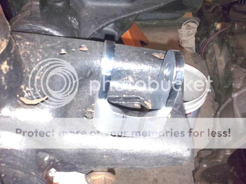

I was wondering how you mounted your track bar to the axle? Looking back through your posts it doesn't show very well. Could you post a picture of how it looks??
Thanks
Thanks for the info in the shock info, ill look up that "bar pin eliminator", that might open up the variety of shocks I may be able to use.
You could do something like this. I got these for free from a friend but he got them from RuffStuff I think
i mounted my trac bar using the factory jeep mount used for the steering stabilizer. it worked out well for the amount of lift i have and the factory pitman arm. I will try and snag a few pic's for you tomorrow. i highly reccommend drilling the bolts for the steering and using castle nut's if you go this way. i though i would get away with just using lock washers and ended up driving about 2 miles with zip tie's holding my steerin onto the bolt.

what escourt is using is very similar to the bar pin eliminator's but the actual eliminator's are bolt on and for 20 buck's what the hay
Thanks for the pictures so I know what to look for, you can tell Im a total noob at this stuff, but now I know what to look for.
