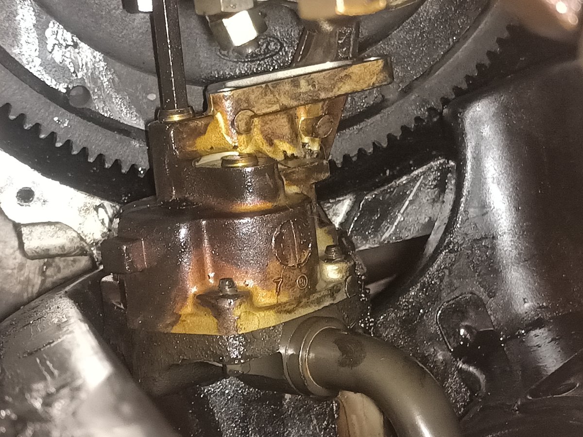

I am attempting to replace the oil pan gasket on my 1994 3.0 Ranger. I've unbolted the block mounts and the tranny mounts (to the frame) and have the block/tranny jacked up just about as far as it will go. I am not going to lift my engine out or unbolt my tranny from the block unless ABSOLUTELY necessary. I already used shears and blades to bend and cut through the metal inspection plate (seen on the left side of the picture below, bent off to the left side) between the block and tranny, it holds the oil pan in place. With that removed, I am able to drop the pan down a significant amount and see what's inside. I have been looking around for a diagram showing how the oil pump is mounted inside the oil pan so I can find out which bolts I need to remove to free the oil pump. In this picture, it looks like the bolt on the right side of the pump (somewhat centered in the picture) going upwards into the block may be the one holding the oil pump in there, can anyone second that?

You realize that the inspection plate aligns your starter to the flywheel…right? You might as well pull the trans at this point, ruining the block plate will cause you all sorts of problems.
the bolt that holds the pump is directly above your arrow. N606563-S
your arrow points to 1 of the 4 bolts that secure the plate on the pump.
star? *N803661-S is what adjusts the bypass pressure, don't mess with it.
when you drop the pump the driveshaft 6A618 may also fall out. you'll most likely need to remove the distributor/sync assembly to put it back in.
well, maybe not. put a gob of grease on the top of the shaft and see if it sticks in the bottom of the sync assembly.

Last night I dropped the oil pump into the pan by unbolting N606563-S but it is being held in place by that pump driveshaft you mentioned, 6A618.
On that diagram I got from Ford it shows a 'C clip' looking thing on top of the pump driveshaft, on the pump end of the shaft. However, I could not feel any openings in the raised section encircling the shaft that might free it.
Does anyone know if there is a way to disconnect the oil pump shaft from inside the oil pan? Or does the block/tranny assembly simply need to be lifted up high enough that the shaft becomes free from the block?
