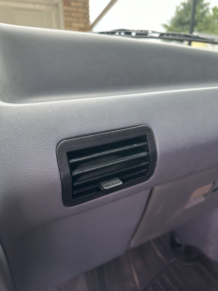

93 Ranger Dashboard Vent Replacement
Wanted to share something I’ve been working on recently. The old dashboard vents on my 93 ranger had seen better days. I figured junkyard options would be just as beat up so I decided to make my own. It was a super fun project learning how to design and 3d print functional parts that fit together as an assembly. Next step is to reprint in gray to match my dash.
How expensive is the material used to print with?
does it come in sheets or powder or what. How do you fill the printer?
I use a FDM style 3d printer. The most common and basic type. The plastic filament typically comes in 1kg spools. Essentially a plastic wire that’s fed into the machine and melted then extruded
