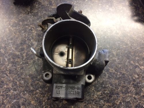

I take that as a no on the pictures lol I'm sitting here watching television not looing at throttle bodies :).
Not mine, but this is what the hole looks like.
Hmm...perhaps I was pre-mature in regards to excellent drivability with hole covered.
