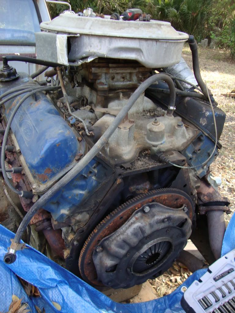

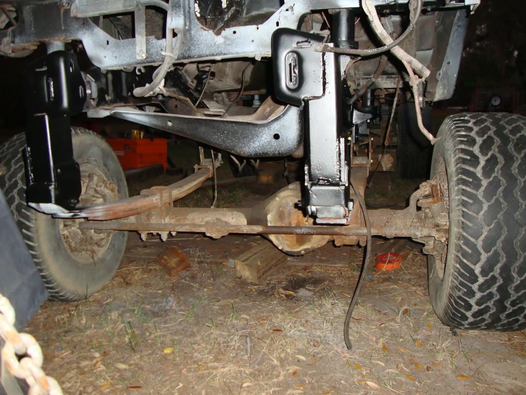

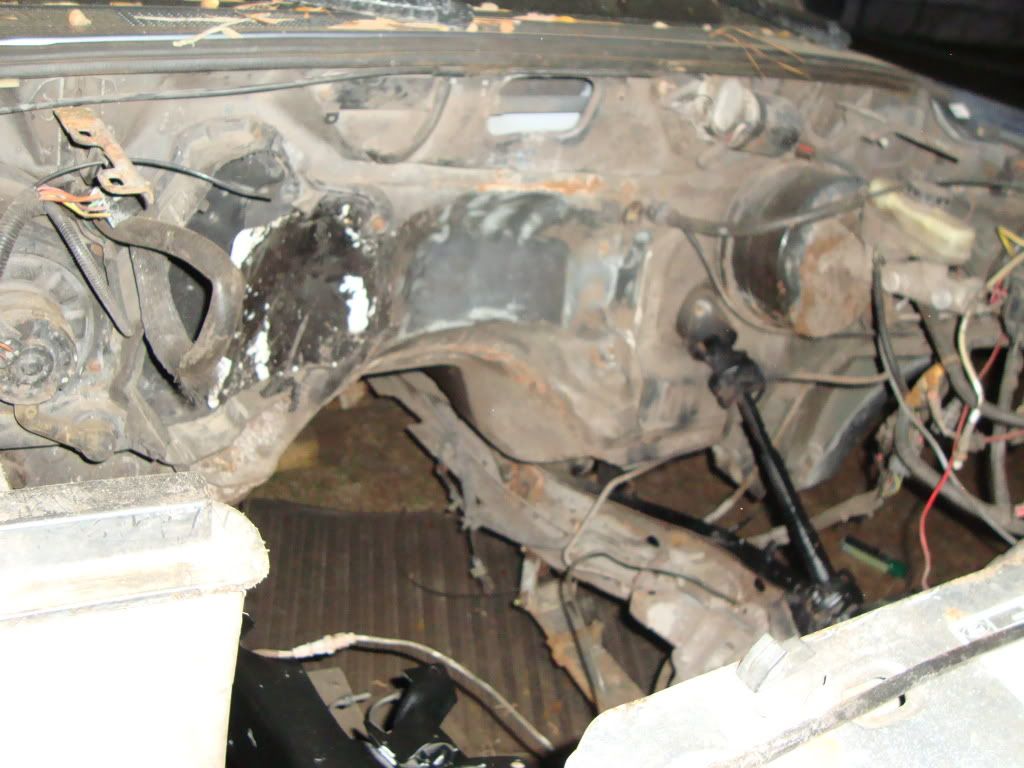

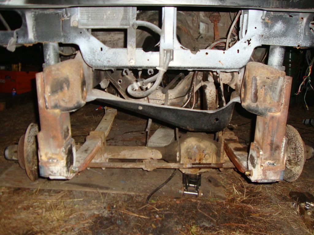

Been really busy lately but got the suspension DONE truck is now sitting on it's own weight. Also took the 302 out and started getting ready to put the 351M in.

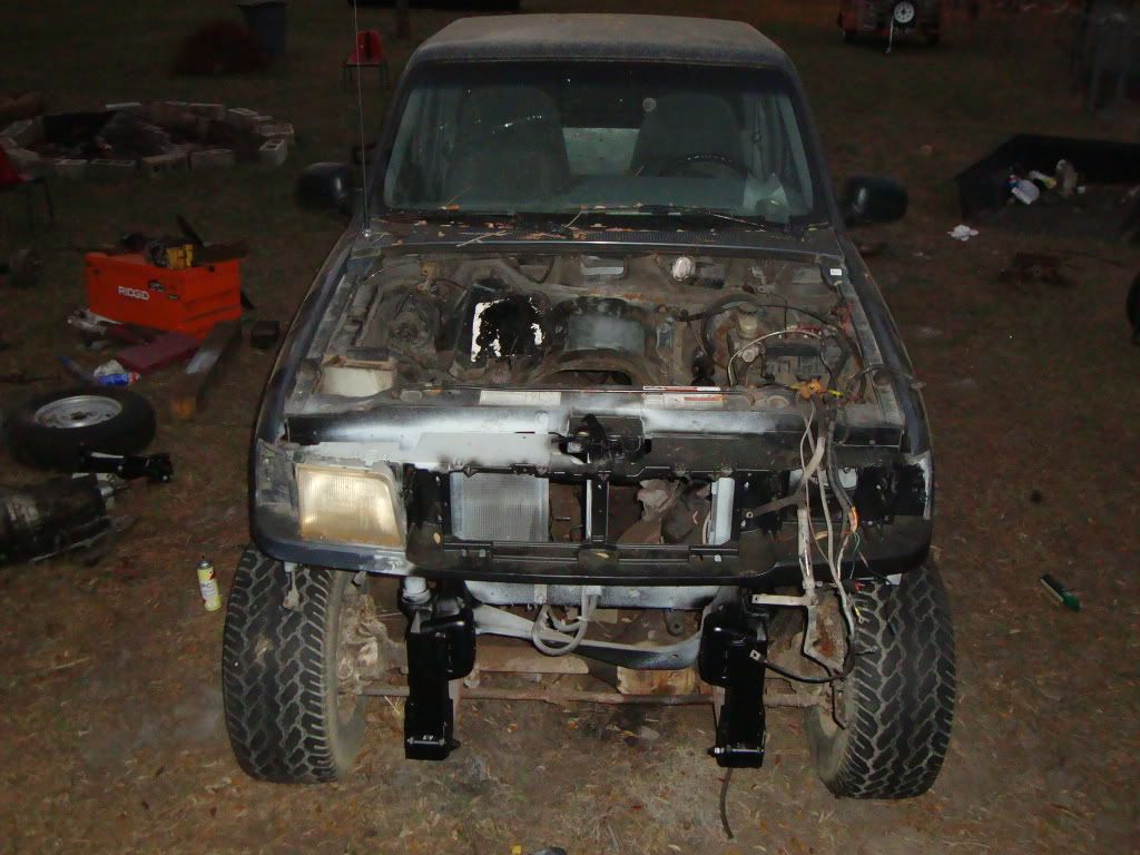

Engine bay empty

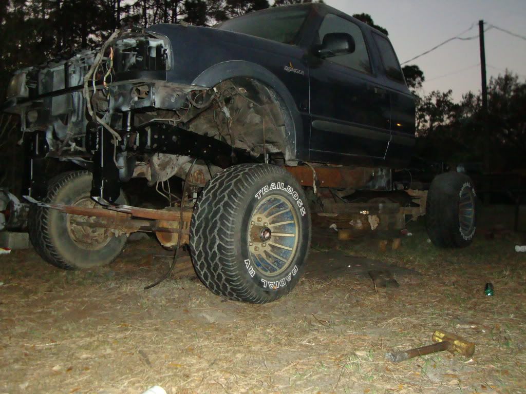

Sittin on 33's

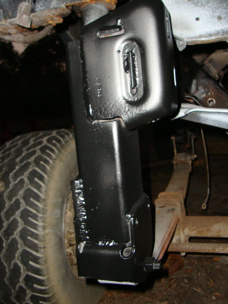

Rear spring mounts
302 out
Empy engine bay

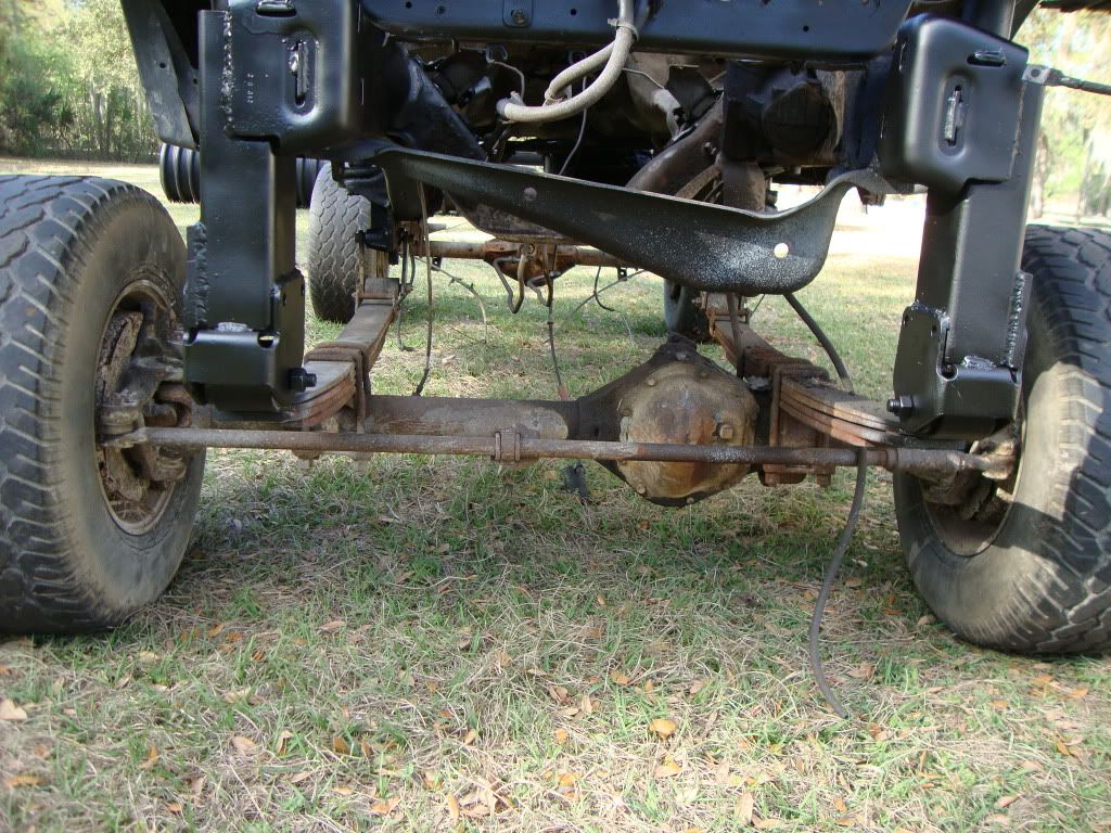

Front end

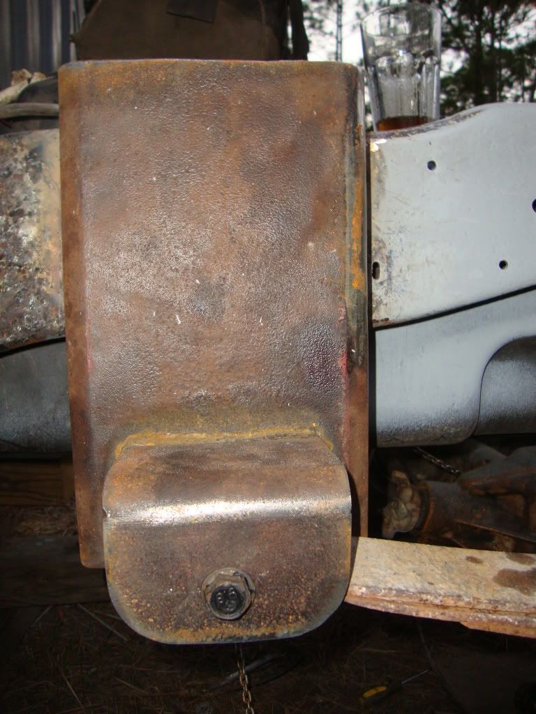

Front Spring mount
you do realize your going to have to chage your name after this right? lol and i think id brace between your front spring mounts so its a more of an l-----l shape the dotted line being the new crossmember
lol why the name change? and yeah im gonna put a brace in there my dad's doin the welding for me and he's outta town right now.

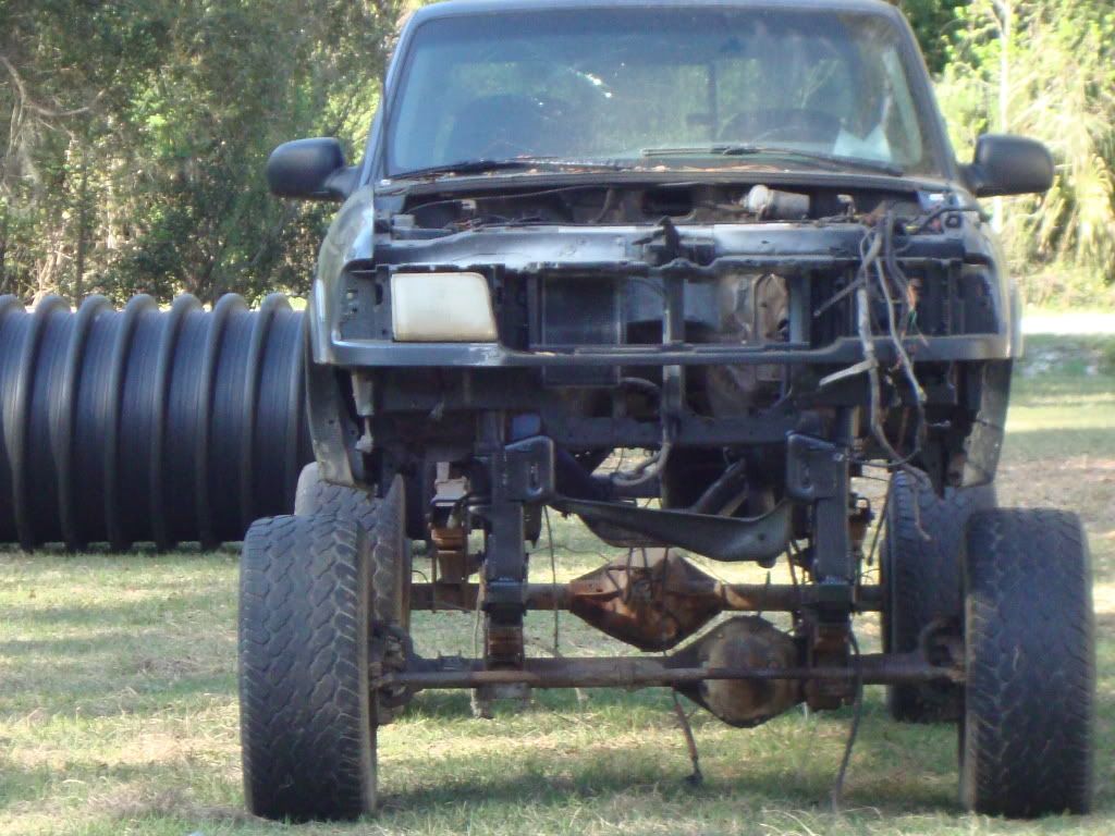

Rolled it out into the yard and took some better pictures today.
351 Modified

back on with the build. that ranger is HIGH. hope u got a good size tire to run lol she looks sweet though, u are doing good work. and have you researched on putting a big block in a ranger? there is alot involved, what are u going to run for headers? i highly suggest u check out bigblockranger.com
keep up the good work buddy
yeah its a little high lol thats how i like it im gonna be running some 38" baja claws for a while my buddy had a set layin around he's giving me for free.

Please don't take this the wrong way. The following is meant to be constructive criticism.
The front spring hangers on your truck are too long and therefore significant leverage is going to be exerted on them. Not to mention the fact that it will kill your approach angle. Second, the shackle angle on your front springs is very poor, they should be closer to 45* rather than 90*. Third, the way you have out-boarded your springs in the rear is not only unsightly, but it created a lot of unnecessary, extra work. It would have been easier and better to simply relocate the spring perches on the axle that way the pinion angle could be adjusted at the same time.
While trying to save money admirable there are some things that you just can't skimp on.
I truly hope you don't plan on driving this truck on the street. I suggest you do some research before continuing with this project for your safety and the safety of others around you.
