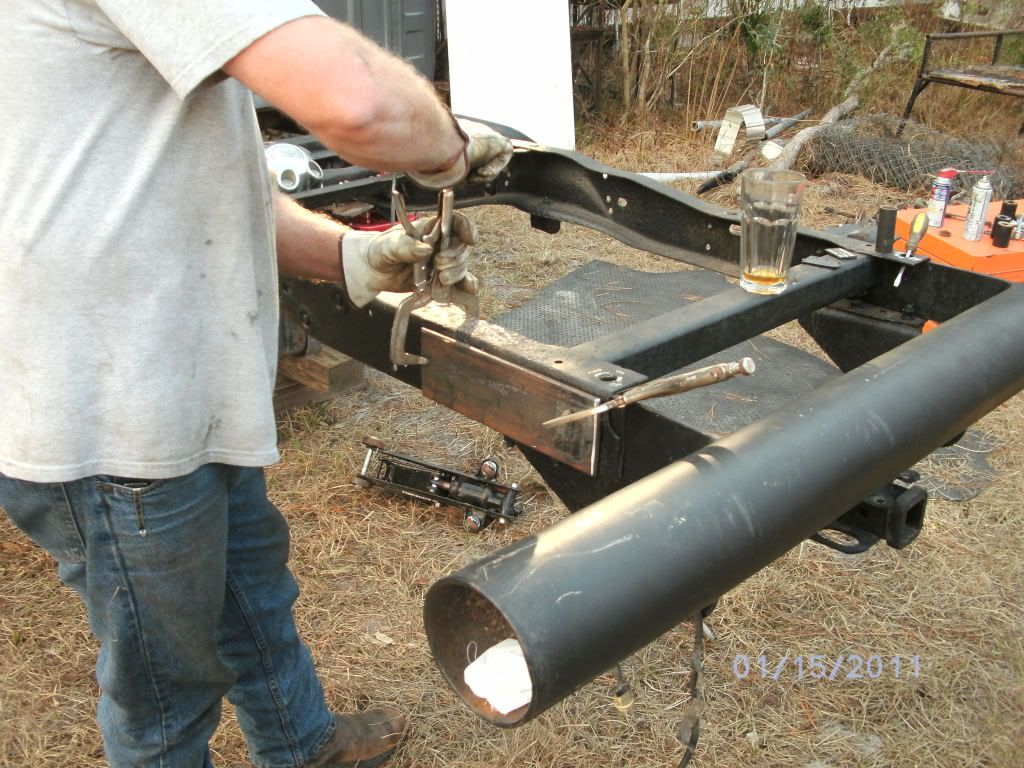

Custom rear pipe bumper.

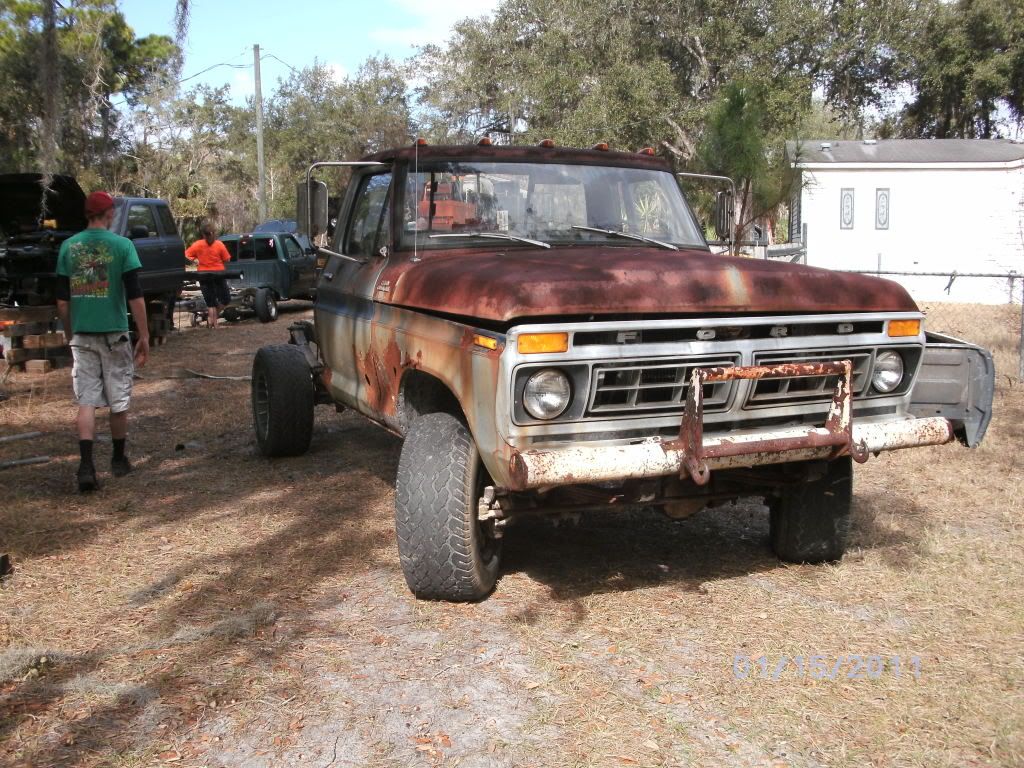

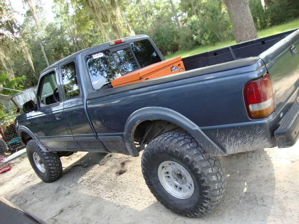

this is how i bought the truck before the body lift.
93 ranger 3/4 ton sas with leaf leaf springs and v8 swap

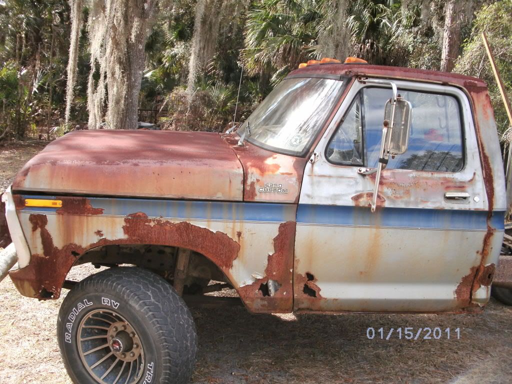

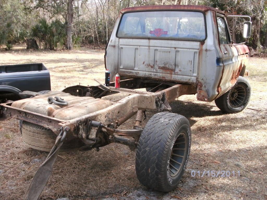

77' F-250 3/4 ton. Picked it up for $1000 built 351 winsor.

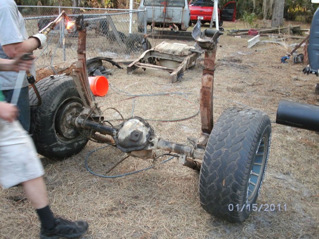

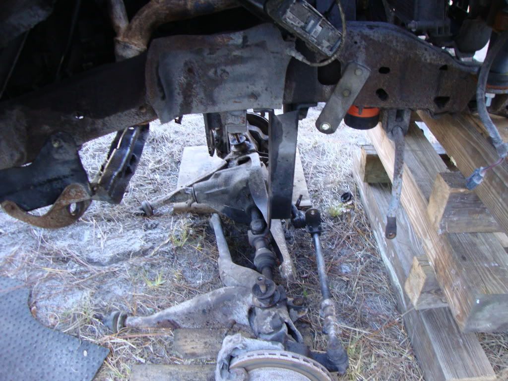

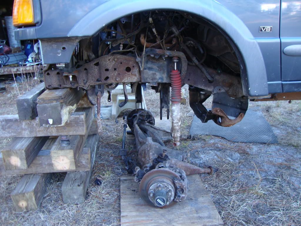

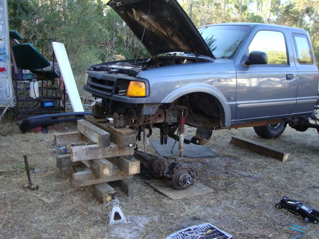

Front axle on ranger pulled.

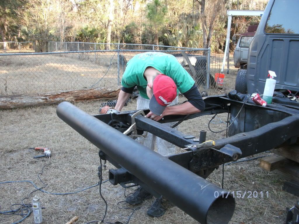

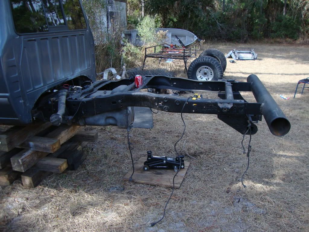

Rear axle on ranger pulled.

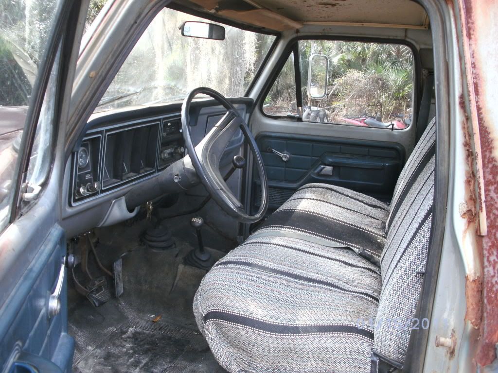

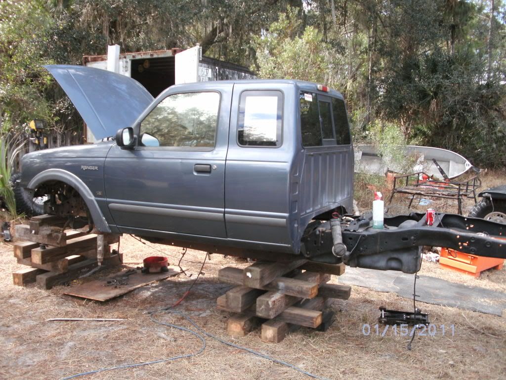

F-250 cut in half.

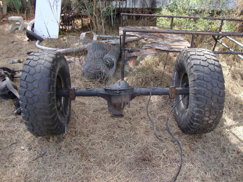

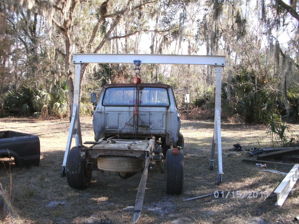

Rear axle out of f-250

Not bad at all! I'm digging the F250, too bad it's being chopped for parts.
Either way, truck will be even better with what you are putting in. Are you freshening up that 351W?
well if the f-250 body wasnt so rusted up i would tag it and drive it everyday i love that truck. as for the 351 im gonna clean it up and paint it and put a few new parts in it here and there it runs like a dream already no ticks or knocks.

sorry i dont i have pictures of the motor in the truck already. some advice if you plan on doin the 302 swap put on a body lift it makes so much more clearence for the motor.

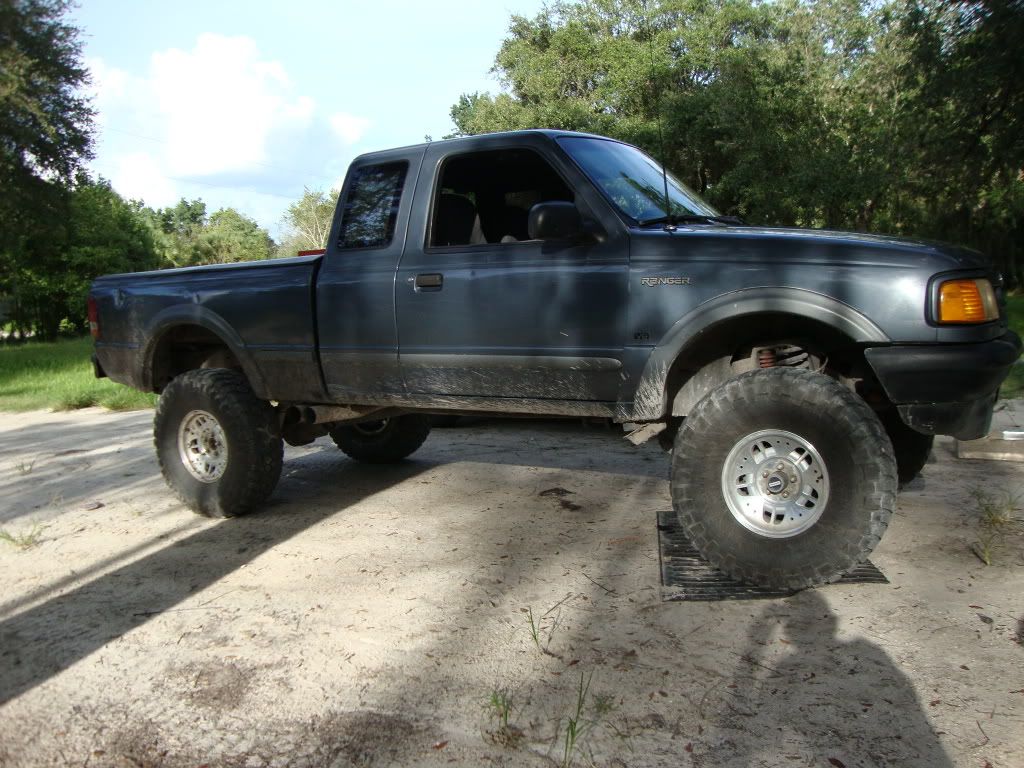

before the project how i bought it
