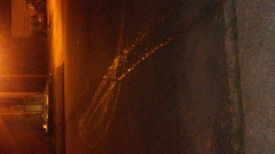

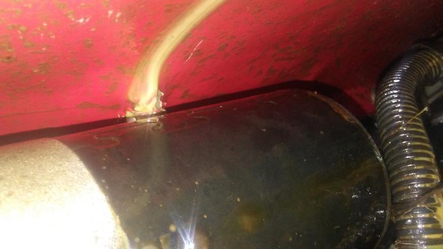

The way i found out was because... On saturday night i was on my way home from picking up a lift kit and about 1/4 mile from my house the motor threw a rod, i limped it home by coasting down the hill. Once i saw the long trail of oil/coolant mix going up the street i knew what had happened. The wrist pin broke loose and took out a coolant jacket and then ejected the rod out the oil pan. I found a new motor which i'll be installing this weekend hopefully.
