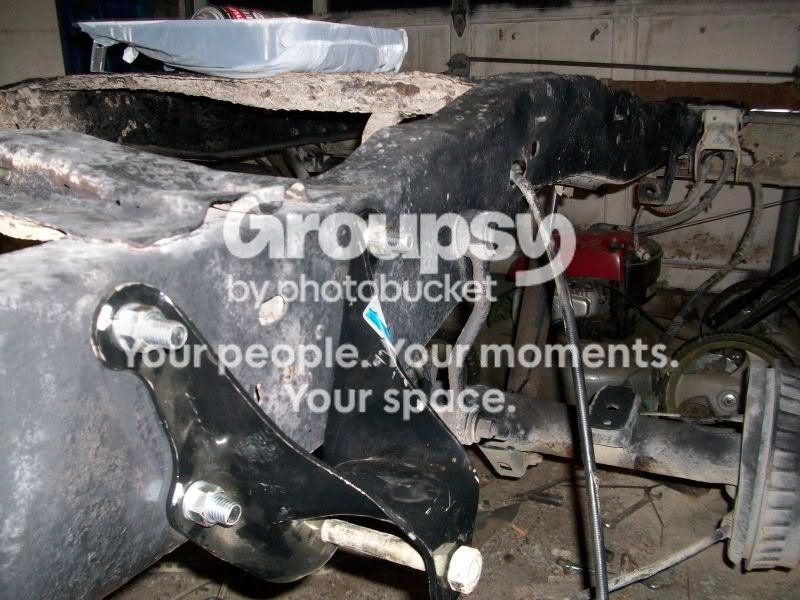

New bracket and bolts! Stupid brackets take for ever to come off and 2 mins to put on.
