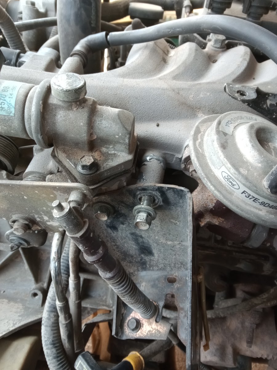

In Tucson Arizona looking for a second gen 3.0 v6 upper intake manifold to replace my current. some how managed to crack the upper intake manifold where the accelerator cable housing bolts on, leaking enough to throw code. I've done my best to scrub through forum to find alternative solutions, (different model compatibility) and seems like my only choice is jb weld until I find a replacement so any advice or direction otherwise would be greatly appreciated. Pick-n-pulls in state don't inventory their models with the engine specifications so hoping to find some help here before starting a hail mary road trip. Thank you.

post a pic of it.
might also find one on a Taurus or other models.
post a pic of it.

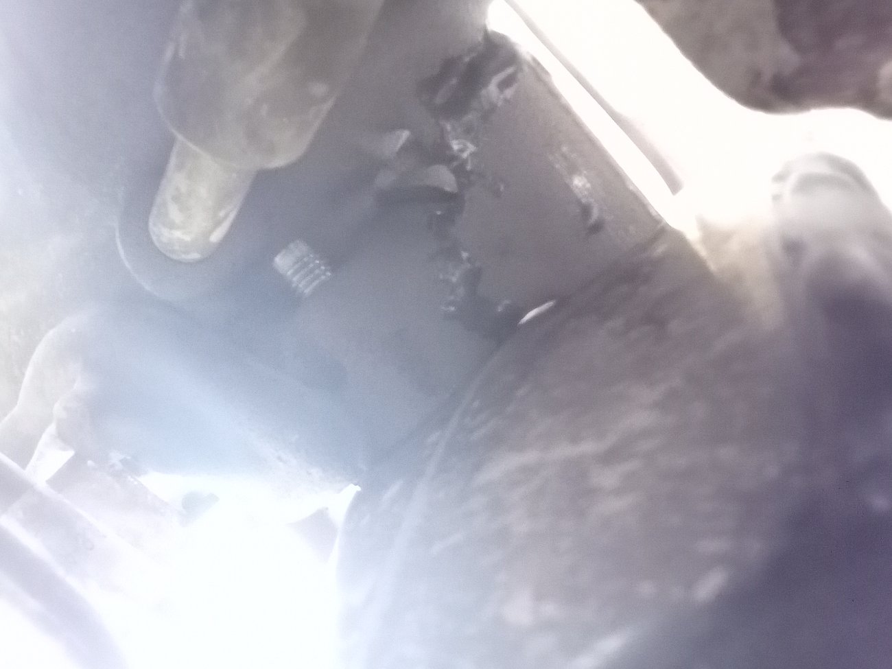

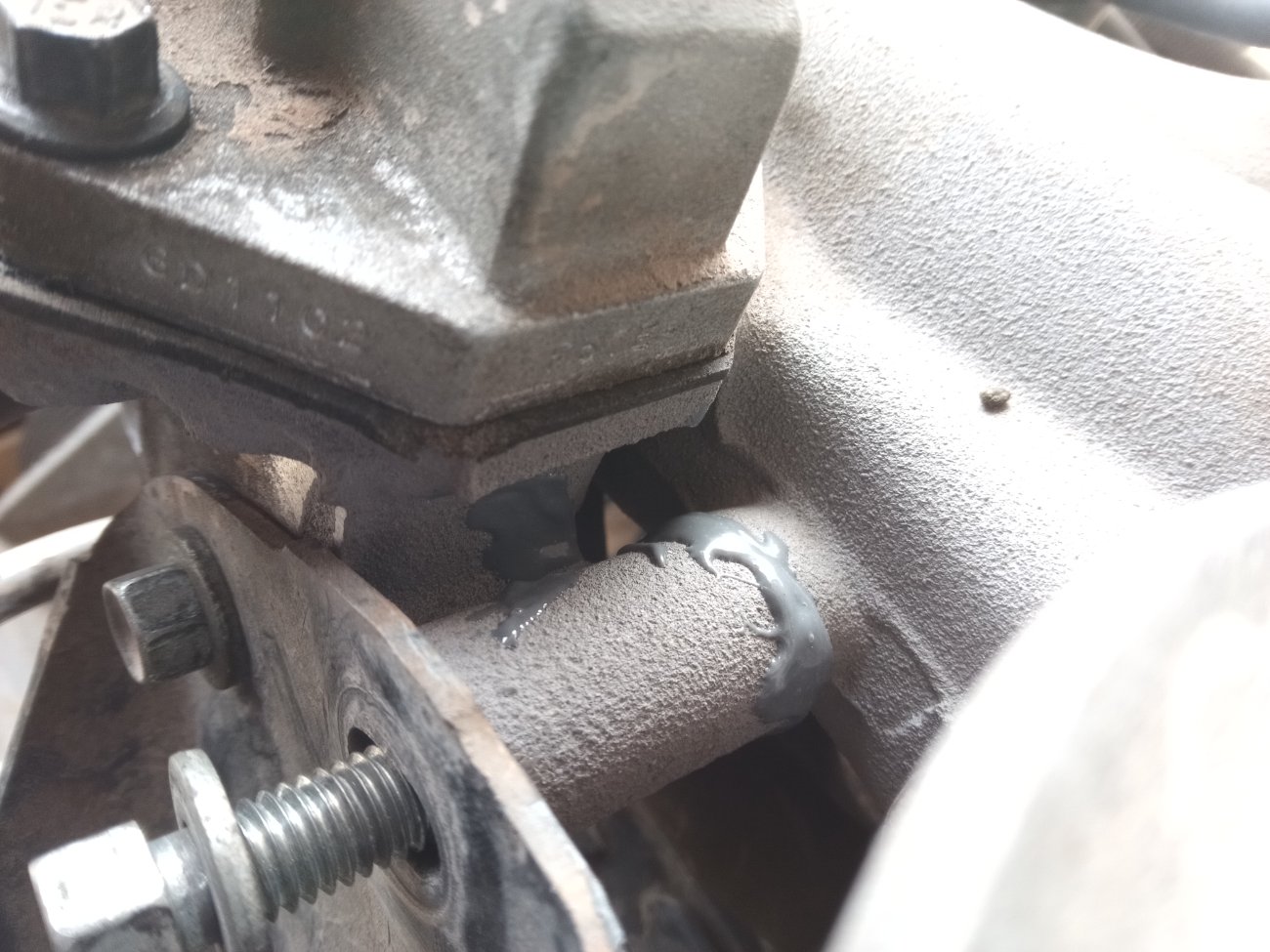

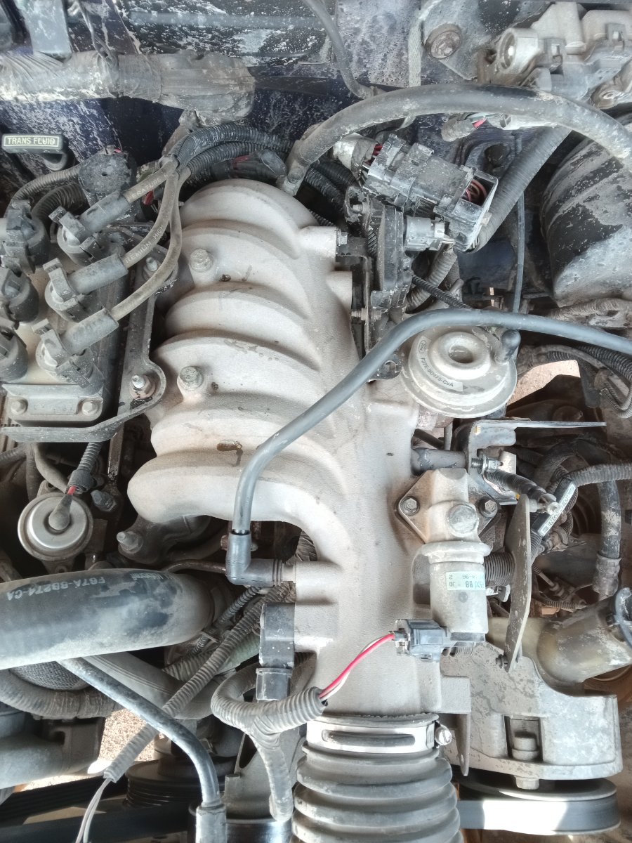

middle photo is from underneath perspective. the crack is the circumference of the bolt housing and continues over to the side of what I believe is the EGR mount. looking to throw some new gaskets at it to see if the jb sealed the crack enough to clear code but still ideally looking for a replacement upper plenum.
I'm not 100% sure but it seems through digging the only option I have for replacement is the 3.0 v6 vulcan cast alu plenum found in rangers and b3000's? @Curious Hound can you put an ear to this? maybe even tell me how I may have accomplished the crack in the first place. Much appreciated.

Wow! I have no idea how you broke that. I believe you have more options on intakes. In later years, there was a plastic intake with removable throttle body. I was under the impression that even that would interchange. I had gotten one from the junk yard. But never pursued trying it. I recently sold the last of my spare intakes. There is a good bit of info in our tech library. Start here;

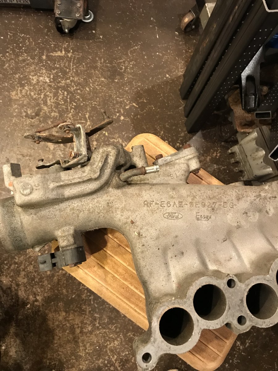

looks a LOT like an early Taurus manifold.
see if you can cross reference part numbers.

I had seen you selling some in past posts but just missed the boat. I'll do another deep dive on tech, looking to just do the swap and gaskets if possible. As surprised as you on the spot of the crack, its actually along the underside of the idle air control valve mount.
you think I could find those numbers on Fords website? as for reading on the taurus, plenty of generations are listed as 3.0 v6 "SFI" Vulcan but my understanding was that they're all fuel injected so wasn't sure if there was a true variation or redundancy.

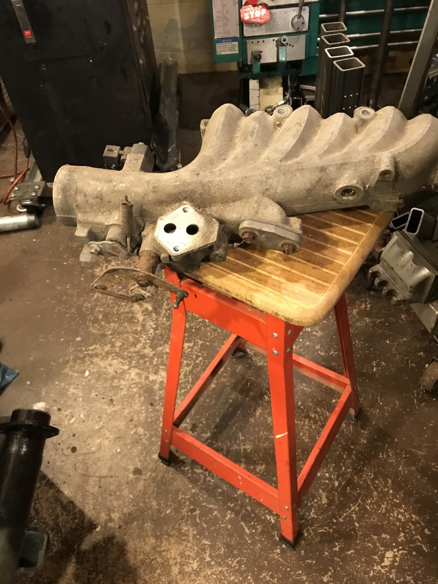

I'm reasonably certain this is from an 87 Taurus
EDIT: closer look shows the PCV inlet on top & next to the TPS in the OP's pic, on the bottom on this one.
so, it's close but not a direct swap.
found and swapped. thank you all above. plenum was cracked because too long of bolts were used to mount the accelerator bracket.
