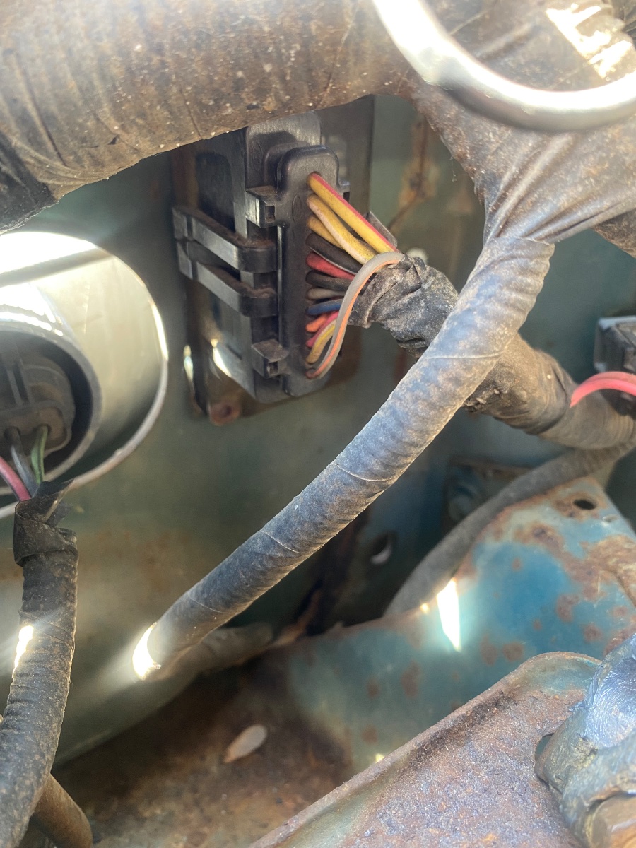

Went to start it today and it was doing the same thing constantly running with the key off. Messed with the electrical connector and now it runs constantly with the key on.

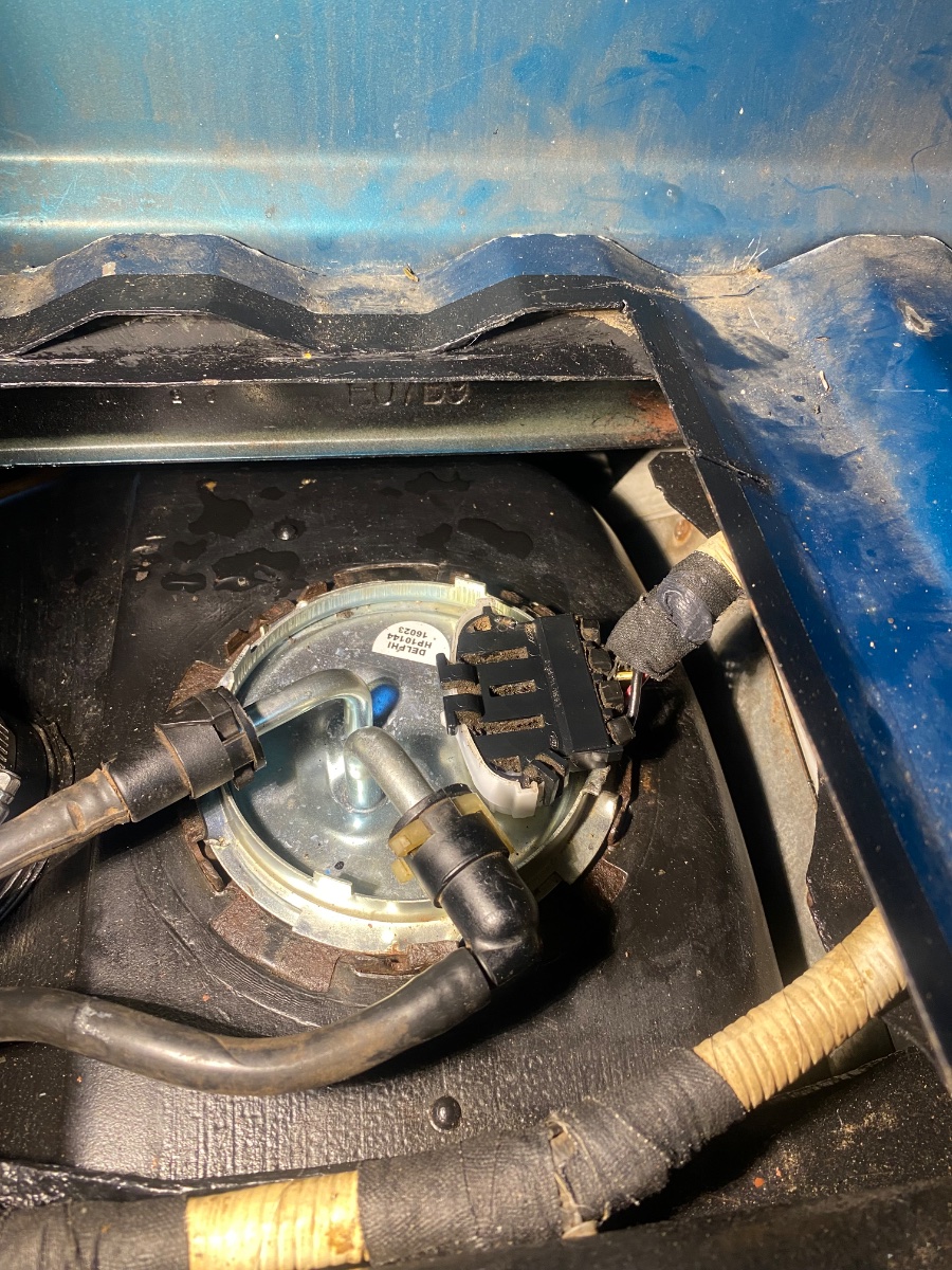

Also the lock ring for the pump is interfering with the wiring connection keeping it from fully seating.
Hopefully the picture explains it.
I’m thinking I’ll have to modify the lock ring, and I’ll need a new connector?

There is nothing about that connection that would make the pump run continuously. It just can't happen. A bad connection would make it NOT RUN. I'm afraid you may be looking at an ECU problem. Maybe the infamous bad capacitors.

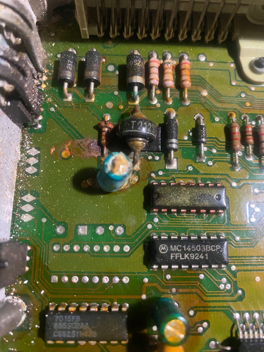

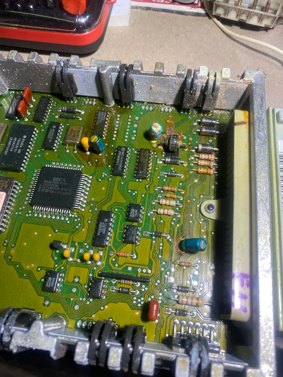

I don’t know how it acted normal the other day?Pulled the ecu and sure enough the caps are leaking all 3.

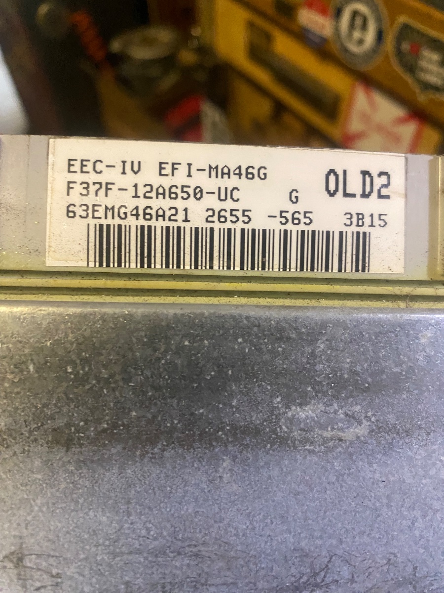

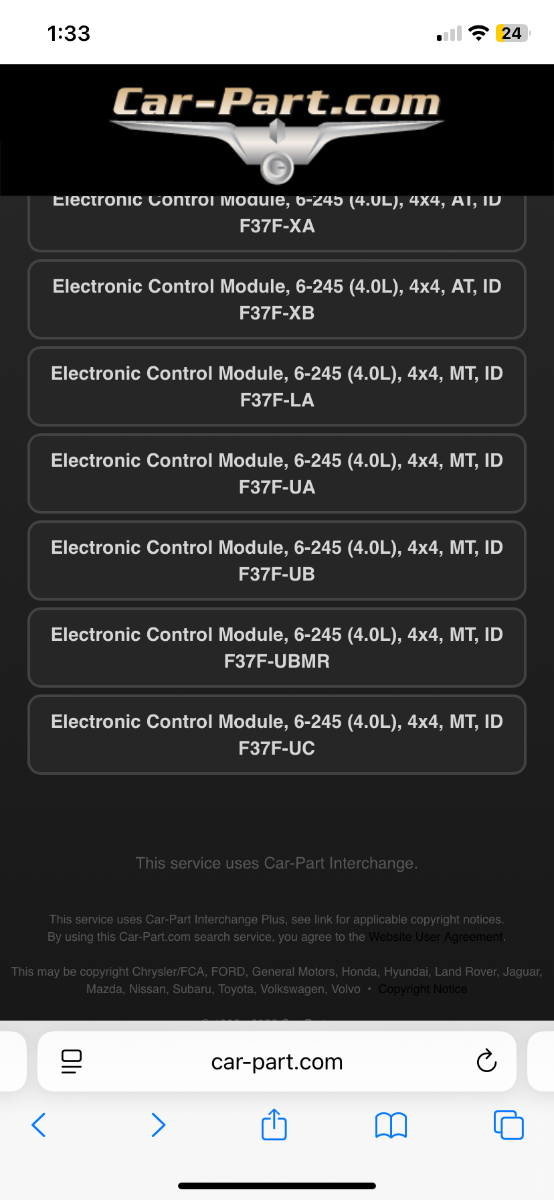

When searching for a new/used ecm does it have to be f37f-UC or will another one work? I see on car-part.com they list 5 different ecm’s for 4.0,4x4, and manual transmission

I can't definitively answer that question. I think the last letters are just minor revision numbers and don't matter. But, wait for someone more knowledgeable to chime in.
