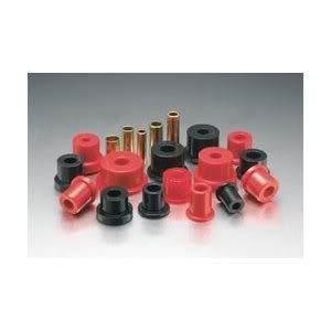

Rear springs bushing are being replaced by Energy Suspensions new leaf spring bushing kit
. All the bushings on the truck are squishing out the holes from dry rot. Needless to say I am getting around to all of it at some point.

I like the wheels. What kind of driving do you mostly do with the truck? Any off roading or just street driving/hauling? I have mostly avoided urethane bushings in my truck. I use them in my street/ autocross cars, but by my experience they don't last as long as rubber bushings, not to mention they can beat you up a little on the bumps. I originally had urethane beam and radius arm bushings, but have recently switched back to rubber. I am swapping leaf springs soon, and intend to run rubber bushings in them as well. Some will likely disagree with me on this. I figure it is a preference thing.

I was wondering if poly bushings would be a problem. I had noticed that they were a bit stiff on my focus when I had it dropped to the ground. Hopefully It wont make to much of a big deal or they will be swapped out again. I drive just about everywhere. No mudding though, no need for wench type driving. Dirt road, street, highway, fields type thing. My caster is off. It's one of 3 parts of alignment. Caster, toe, and camber. I'll try to get the rest of the front end parts but $$ will an issue from here on out. What would be the most detremental and would need tackling first? Balls or steering components? I payed someone to rebuild the rear brakes when the new rear end got swapped. How can I tell if the drumd are out of round? Never heard of anything like that. I do have a leaky rear cylinder....that wouldn't fix the wobble. The shake in the peddle is pretty bad and gets worse with more pressure applied. Thankyou so very much for the response. I was hoping to get some insight before I tackled this any more blind than I already am. so Thanks upnsmoke!!!!!!!
I have the energy suspension bushings in my '96 Ranger 2wd. I don't use my truck for off road. I personally like them. I think they give the truck a tighter feel. I also put Goodyear Wranglers on my Ranger. I went with the 235/75/15. Yeah, 15 inch tires are cheaper than 14s. In doing so, I had to change the rear axle. I went from a 7.5 with 3.45 gears to an 8.8 with 4.10 and a limited slip. I went with monroe sensa track shocks. For the street, they work fine. I just recently added the F-150 coil spacers in the front and 4X4 blocks in the rear. Do you have a lot of play in your steering?
Urethane bushings have excellent feel on the street. My father has a Civic with all urethane bushings, Koni shocks, and big sway bars front and rear. I love driving that car. It handles the bumps of Baltimore city streets just fine in my opinion, though it will beat you up pretty bad on a cold morning. The only real problem I have with urethane bushings is longevity. The Civic has about 12k miles on the modified suspension, granted it does get run hard, and while all bushings are present and intact, some of them are exhibiting wear that tells me they are nearing half of their usable life. The driving characteristics they provide the Civic with is worth the labor and expense to me of having to replace them once every two or three years. I have seen urethane bushings last a good bit longer than that in cars that are driven in a fairly normal manner, as opposed to constantly tearing around on sticky tires. Everything is a compromise. It all comes down to what you prefer.

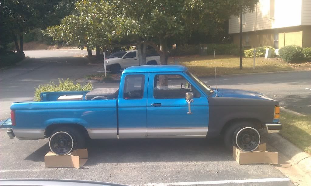

Ok so the wheels were gonna take the longest to ship so I have been holding and buying the parts a few a day trying to earn up my autozone discount. But the wheels came into today a week and 2 days ahead of schedule. SOoooooo It's about to begin!!! Here's a preview....
When I first got my Ranger it had the stock 14 inch rims with 225/70/14. Those tires are about 26 inches tall. When I switched to the 15 inch rims with the 235/75/15, which are 29 inches tall, it throughs off the final gear ratio, along with your speedo. Before I changed the rear gears, I could not use 5th gear. According to the calculator:

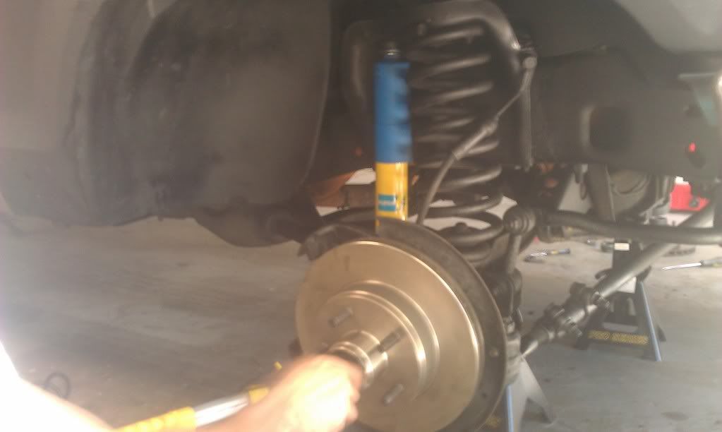

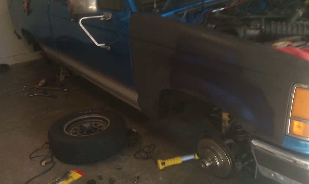

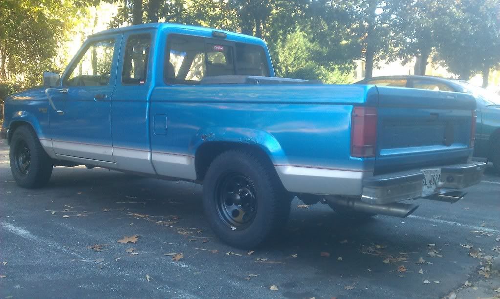

Alrighty here's the update. This portion is over and gotta finish paying off these parts and what not before I can start on the next list for the truck. The parts that went in.. Bilstein front and rear shocks, new balljoints(driver side was shot, pass side is good for a lil while longer), casters(got alignment), front rotors, bearing, caps, pads, rear wheel cylinders, rear shoes, 2 brake lines(flushed all lines), radiator flush, thermostat, upper/lower hose, heater hose, vacuum hose off pcv, never could get the bolts out of leaf springs for those bushings(part not in yet), 2 front cab bushing, ground all rust off front end and re sprayed with rust stop stuff, fuel filter, air filter, oil change, tranny flush, the blackrock 15" wheels95 for $391), 225/70-15 Yokohama Geolanders(5 for $675), spark plug wires and plugs. It took 2 days in a garage to do it al with the help of one other person. The wheels/tires are a close fit. But look awesome. The 4" bs lines tires for a hair of poke out past fender. It looks good!! No scrubbing so far. I can't fit a bigger AT tire and this was the smallest any of the brands carry. This looks and rides great though. Didn't have to many problems on this. Biggest problem was busting the bolts. I still need to tighten or replace steering box and I still have a steady hop at certain speeds. i think I need to figure out how to tell if axle is warped or if spindle is bad...its gotta be something.... Got a quote from Macco for a cheapo black paint job for $350.
Good choice on the tire size. It looks good. As for the hop, sometimes tires take more than one try to balance. If the hop was not present before the new tires were installed, I would take it back to the place that put the tires on and get them to recheck the balance. They should not charge you for that. Otherwise, it sounds like the truck should be in pretty good shape. Certainly better than it was anyway.
