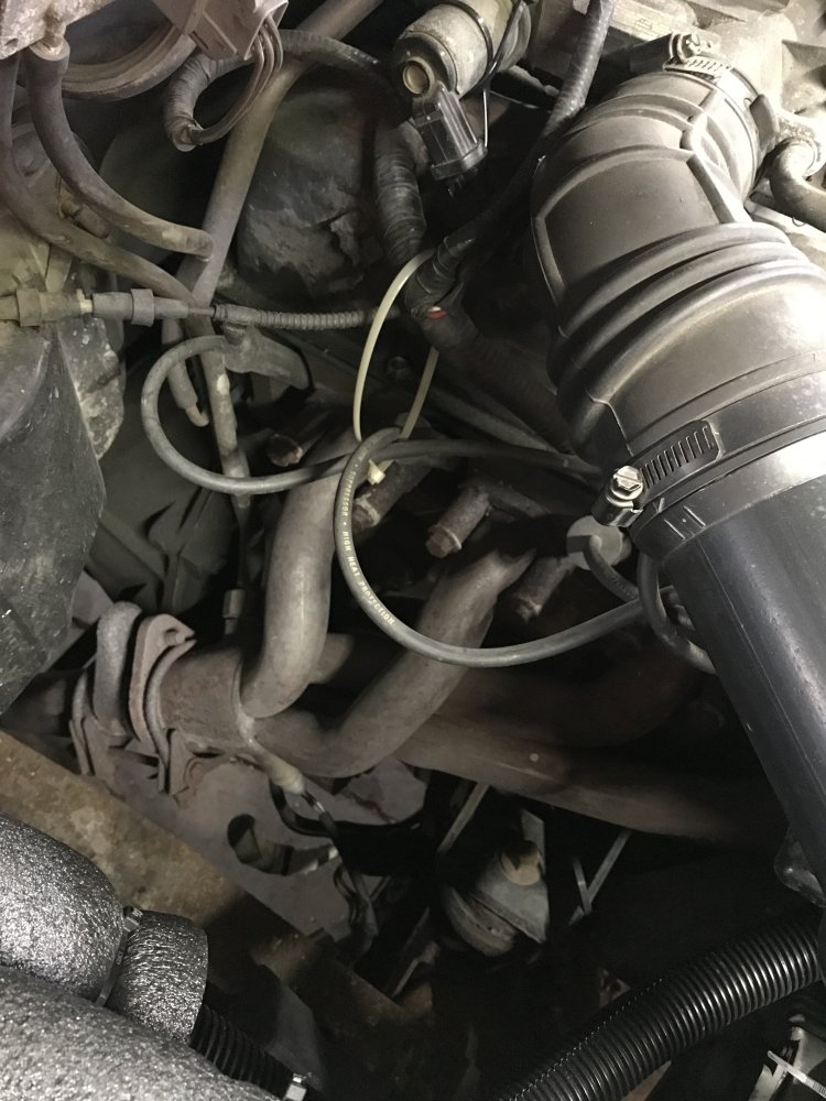

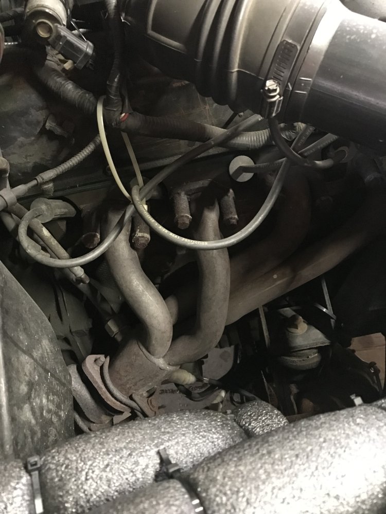

Im thinking of completely replacing my entire exhaust system, manifold to tailpipe, Im having issues locating a manifold, rock auto has no listing for a manifold and fleabay only seems to have a dorman replacement for a 83/92 model year, its fully cast iron, my 94 has a header style, bent pipes welded to a engine mounting flange & the end the converter bolts to. (which has both bolts broken off in). Im thinking the older style cast manifold will work, I doubt I could get the original bolts drilled out & retapped straight. Anyone used a older cast manifold on a “newer” 2.3 lima?
I know they'll bolt to the head, but the question is the DPFE tube and the outlet, I know they changed over the years somewhere but don't remember when... I can get some pictures of the '89 manifold I have in the shop tomorrow so you can compare to what you have...
My biggest concern is the angle of the outlet & if its the same. Went out & took a picture. looks like the O2 sensor goes in from the bottom, the dpte thing is on the top. As you can see (maybe) the downpipe is held to the manifold by a 1/4” bolt going between 2 muffler clamps, one on manifold & the other on the downpipe. I may try fixing the manifold first, the broken flange bolts are all thats wrong with it, might be a better flowing part than the cast iron part from earlier engines.

I'll look tonight, I think the main advantage is the 10lb lighter the fabricated version is though... In the 5.0L explorers if I remember right the iron out flowed the fabricated and they were fabricated before cast instead of the other way around on the Lima's...
