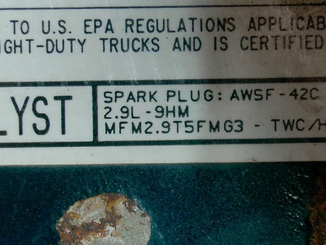

heres a pic of the finished product(the cannon plug isen't wrapped back up in that pic)-
92 4.0l into 91 2.9l truck?
i just need to get rid of this sticker and you'd never know it was a 2.9l truck from the factory
