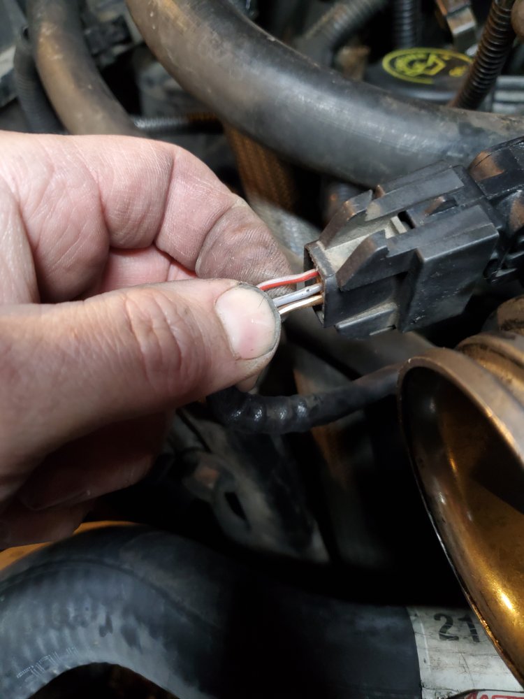

ok, finally got some time to play with the truck. Key on, connector unplugged- Top wire (red w/grey) +5v, bottom wire (brown w/white) +5v, middle wire (grey w/white) nothing. Key on connector plugged in +5v on all 3 wires regardless of throttle position. I should see continuity to ground on one if the wires and the middle should be varying from +1v to +5v.....

I gave you the wrong wire colors didn't I? Brown/white is the 5v supply. Grey/white is the signal back to the computer. Grey/red is the signal return or "ground".
According to the diagram, you should also have a signal return or ground wire on the engine coolant temp sensor, the air charge temp sensor, and your MAP sensor. They all should have the grey/red or in some places it may be a black/white. All these different sensors having the same wire means there is a splice in the harness somewhere that splits this wire and leads it in all those different directions. Maybe you can take some readings on this wire at the other sensors, and see if you get a good ground anywhere in there and try to figure out where you are losing it.
You want as close to one volt on the signal return wire at idle with the TPS plugged in, 5 volts on the signal return indicated WOT.
The grey/red wire runs to ALL the sensors, so test the grey/red on say the IAT(air temp) sensor, should be on upper intake drivers side 2 wires
Its a reference Ground, the computer uses pull down circuit, so not a true ground but should show as Ground
That comes from pin 46 on the computer
Pin 47 is signal return from TPS, just FYI
You could have a short between the two wires at TPS which is why you want to test at another sensor

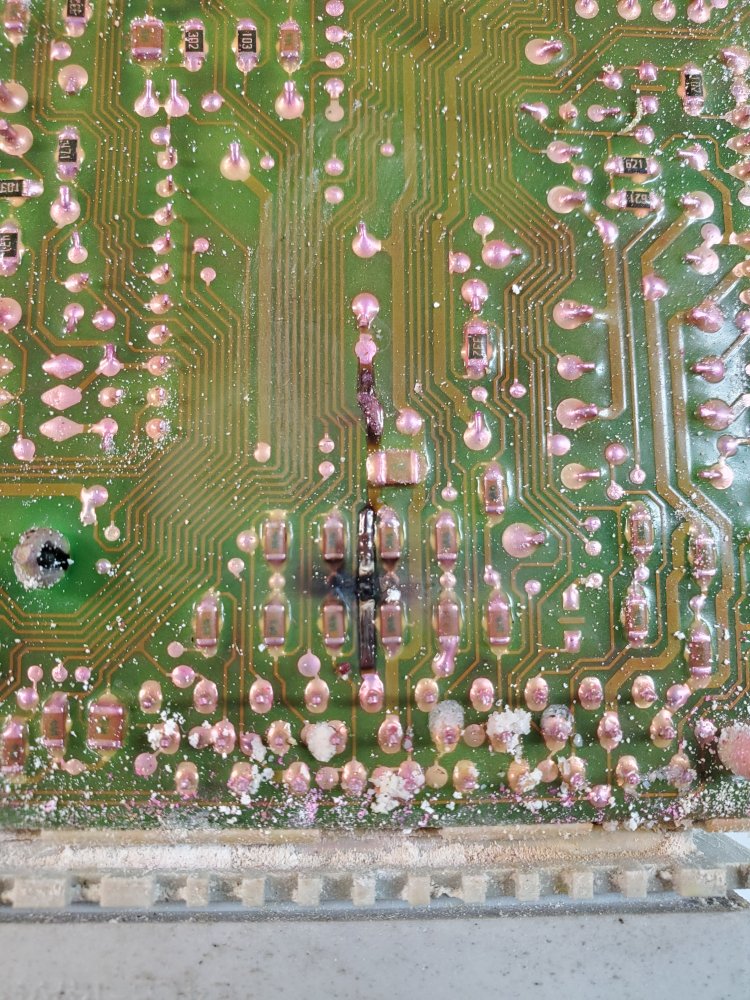

Ended up with a new pcm. Pin 46 signal ground trace inside the pcm was cooked. Running good now!
