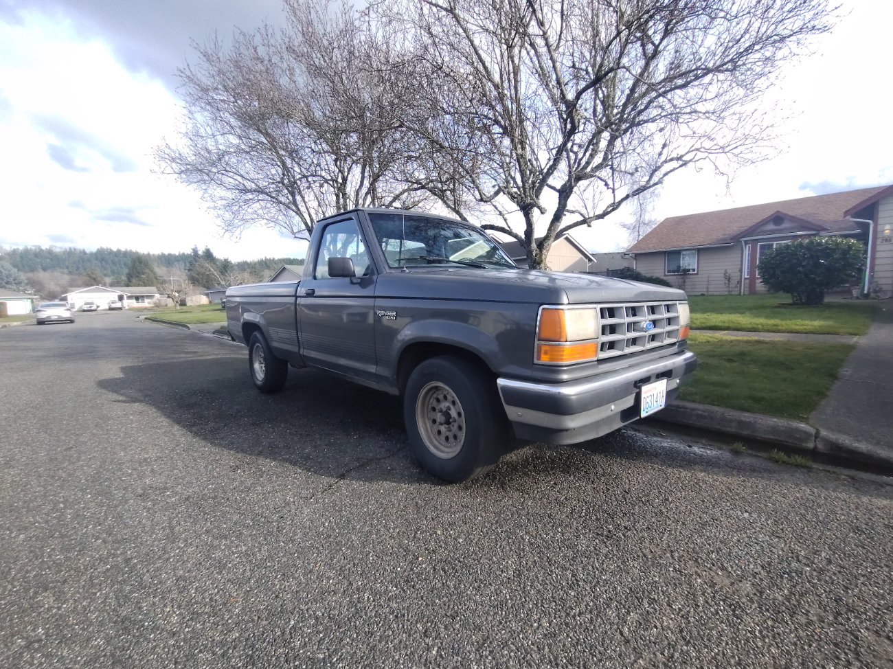

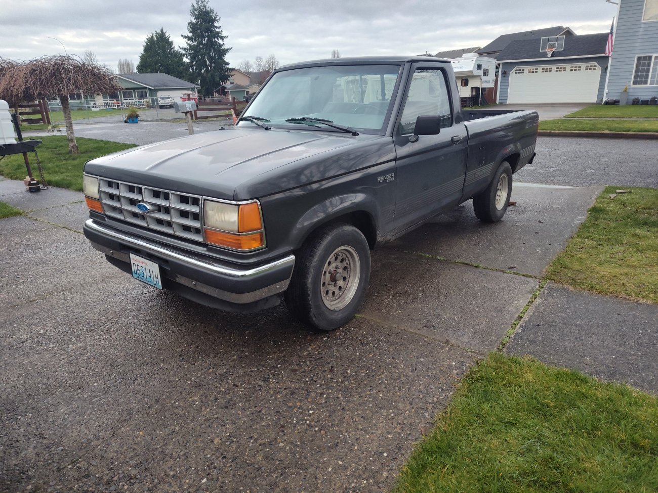

It's turned into a really clean, solid rig that I'm proud of and now I always double take to look at when I'm walking away from it.

Yeah the pic I took of my truck is dirty mid winter. Once the weather gets nicer I'll get it cleaned and buffed and take some good pics of it. Ive done my best to straighten the frowning front bumper and the twisted corner of the rear. I wet sanded the hood but want it repaint it and the roof. One piece at a time.
