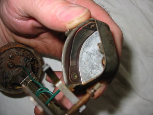

What causes the gauge to read way past full for 3/4 tank and then fly down to reading empty in around 20 miles?
Contacts on the sending unit are worn out, and do not send a reading to the gauge once it gets to a certain level.
Example:
See all those gold horizontal lines? Each one sends a different level of resistance to the gauge. As the contact point moves across them, they wear out over time, notice how they are all worn down? That's probably what yours looks like from 3/4 way down.
Excellent explanation, and picture, BlackBII.
Thanks a lot that was a great explanation and picture. I just had the tank out of my BII to do the body mounts and patch the frame and the connector plug was all nasty and cracked and brittle. Changed that out and hoped it was that (it wasnt) but getting that tank down and out is more of a PITA than using the odometer. I was really hoping it was in the dash or a ground or somethin.
