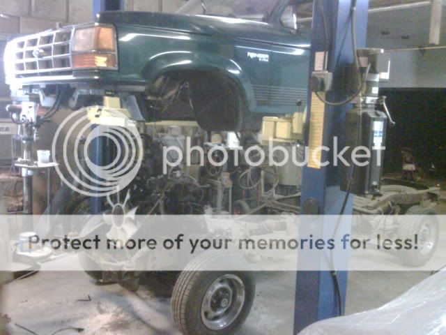

90' BII Rebuild----->> Build-up

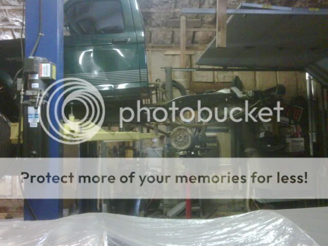

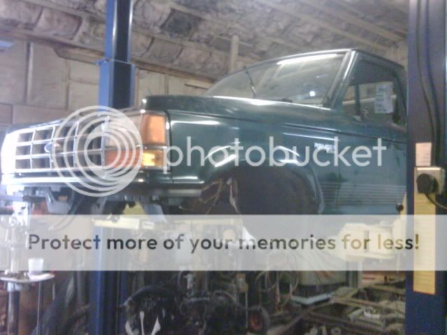

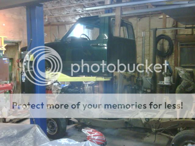

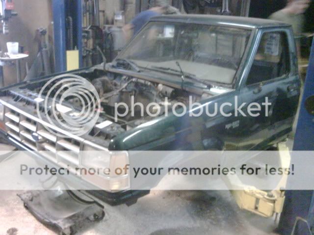

More of the donor cab

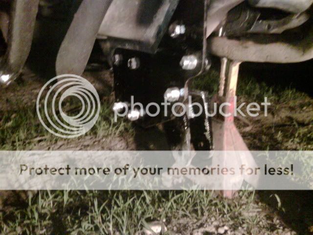

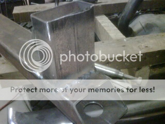

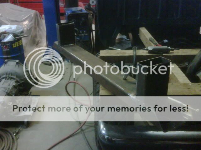

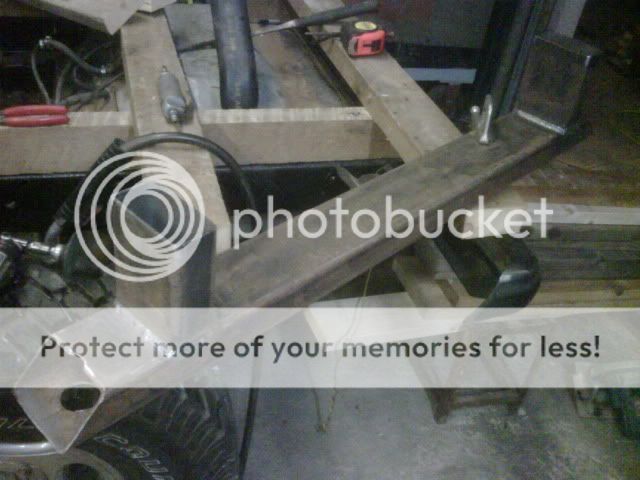

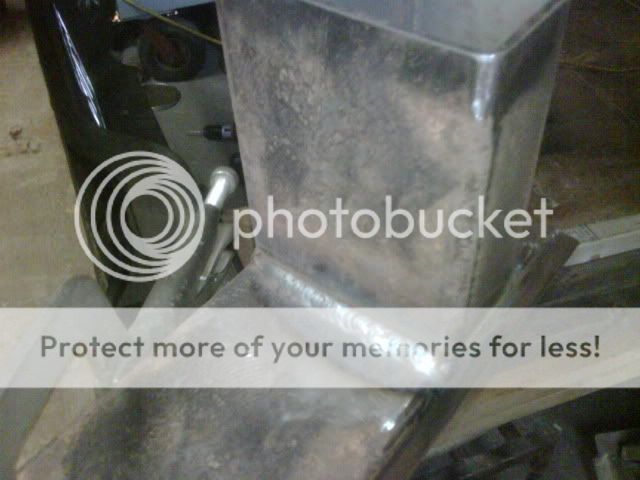

looks nice. what are you useing for rear support for the cab?

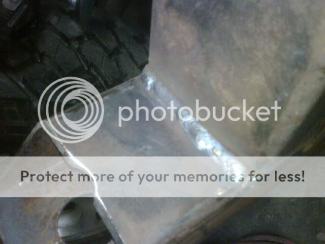

I would do a 4.0 swap if i had one right now so itll wait. as for the rear cab mounts im doing something similar to the ones maverick made.

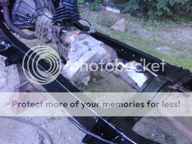

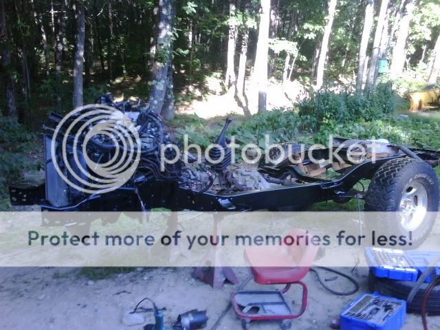

so I got all the wiring done today, dash back in and found out it needs a starter solenoid and also a starter. Runs but oil looks like choc. milk and if you stab the throttle at all she dies. tomorrow im going to pick up a starter, solenoid, plugs, wires and possibly cap AND rotor button

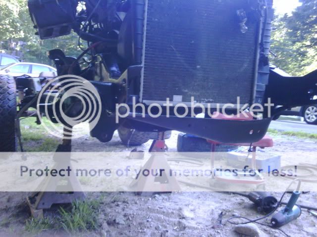

Got some more work done. no pictures but heres what i have done.
-new fuel pump
-f150 leafs
-dash all wired up and put together
-chevy one ton front brake hoses
Coming soon is:
-hurculine the floor in cab
-build rear cab mounts
-build temporary flatbed
-run some stuff over

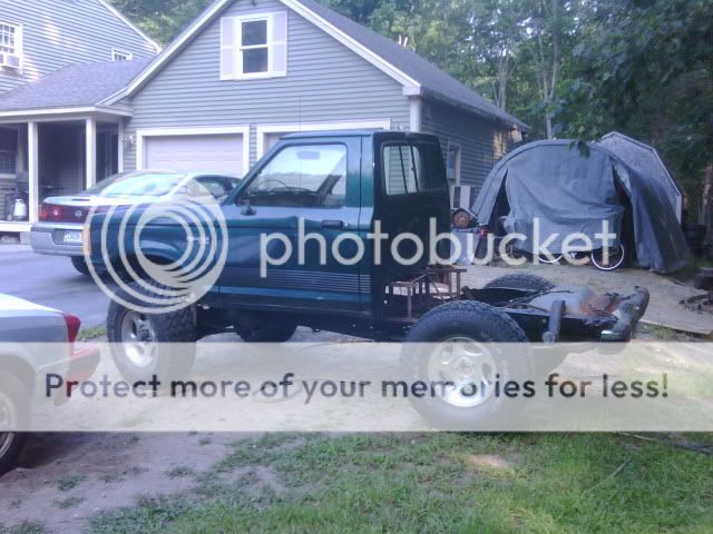

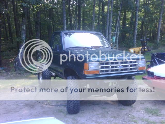

Lookin good, I love the way a ranger looks with the super short bed on a BII frame.

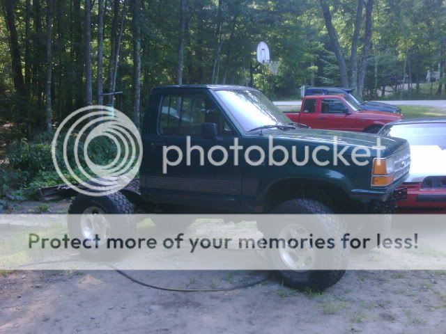

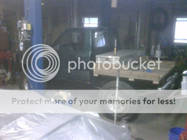

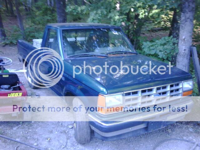

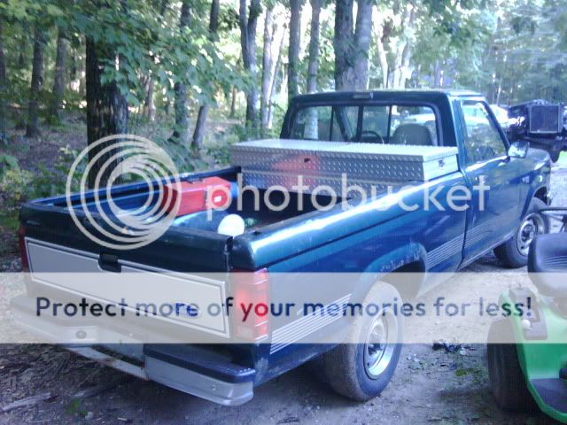

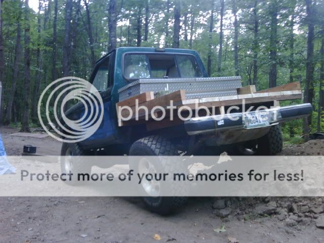

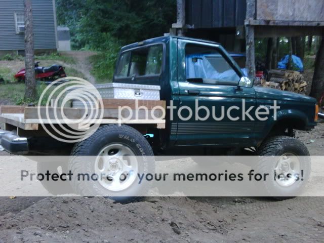

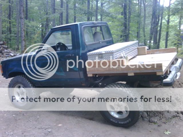

Done quite a bit of work havent posted in a while though. Got the cab on, mounts done. cousin built flatbed in a few hours. Hurculined the floor. I then drove her around a little and found some things that need to be improved apon. Needs an alignment in a bad way. Also need a skyjacker extreme drop pitman arm if anyone has one theyd like to sell. let the picture roll.
Thanks. ive been working on this thing for about a month now after work and on weekends. It was a ton of work but its finally paying off. There seems to be a lot of views but not much posting going on. Anyone else have any imput on it?
