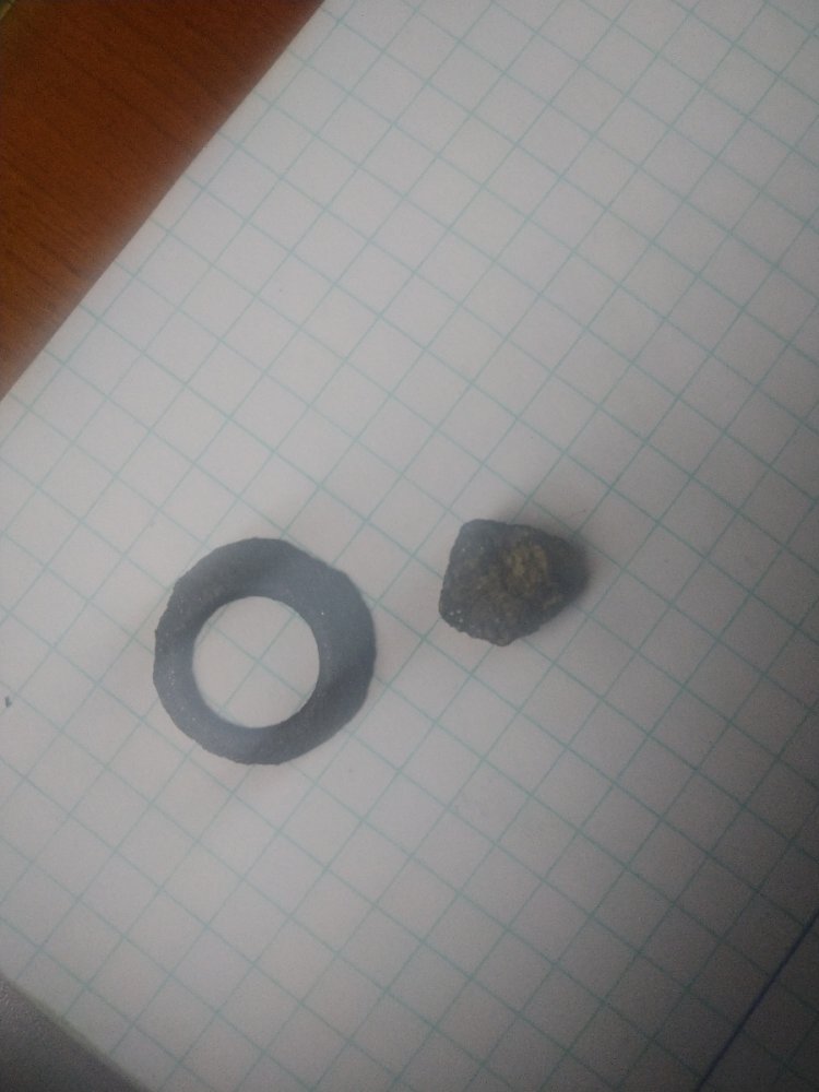

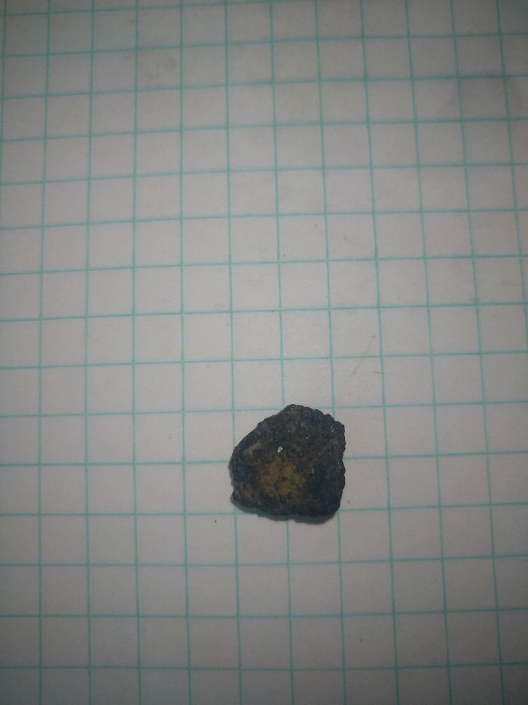

The biggest thing as well is to clean out your coolant passages in your block.
This was in mine.
Graph paper is 1/4"
As far as I can tell, this is why they blew heads.
That's why I tore my engine down in the first place. But I think it was more neglect. The radiator would not even drain it was so full of rusty sludge. Heater core kept clogging up. I finally got it cleaned out and almost every block core plug was leaking. Pulled it down to replace them and found a crack in one of the heads.
