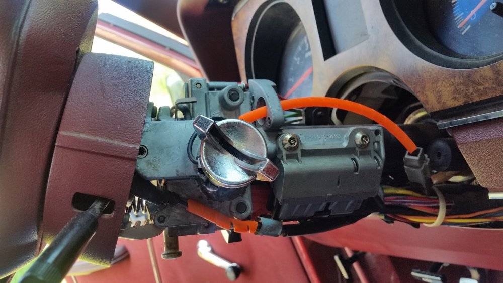

Hey Dow,
The ignition switch is just to the right of the ignition key cylinder. It has two screws at the top of the switch (mine are security torx T27), and two electrical connectors on the bottom. Sometimes the switches start to come apart, as the tabs holding them together start spreading apart. The key cylinder wouldn't cause your problem. It either turns and locks, or it doesn't.

Hey Dow,

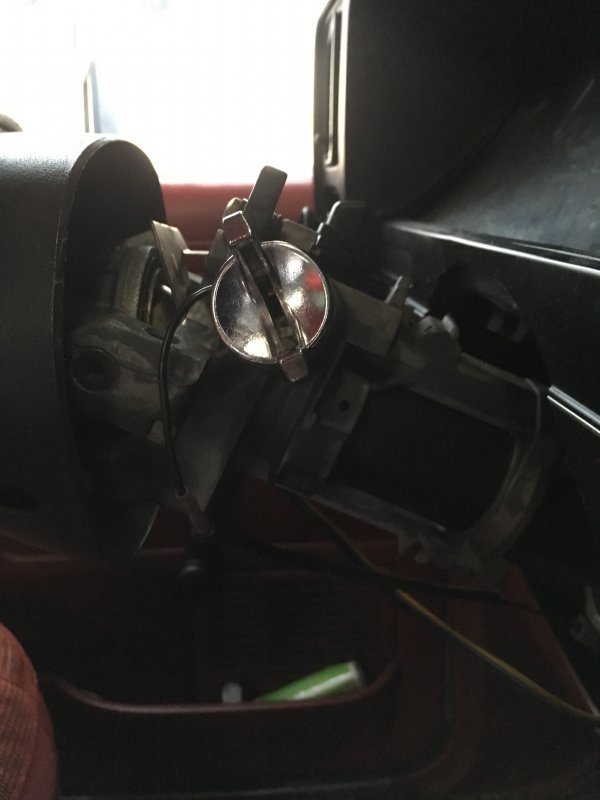

Hey Paulo, this is what I’m working with. I don’t see a switch like you’re talking about.
Hey Dow,
I see what you mean. I assumed that since the replacement switches look almost identical that they would be in the same place.
It must be farther down the steering column, with two bolts or nuts mounted to the column.
Oh boy! Ya, yours must be pre—1989...I traced the wires all the way down the column, and they just go to a huge taped wire harness behind/under the dash. From there...I can’t find the switch. What a pain, there’s plenty of room to have put the switch right by the key like yours.

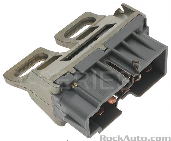

No, it has to be somewhere on the column. When the key cylinder/switch turns, it slides a rod that runs down the inside of the column and the end pokes out of the column into the back of the ignition switch. So when the key moves, it changes the position of the contacts in the switch. It HAS to be on the column. At least you know what to look for, based on the picture of the switch I pulled from RockAuto. I can't imagine that they designed it so you had to drop the column to access it. It looks like there are 11 terminals on the replacement switch, so you have up to 11 wires going to a single connector. And yeah, the '87 is nice and easy to get to.

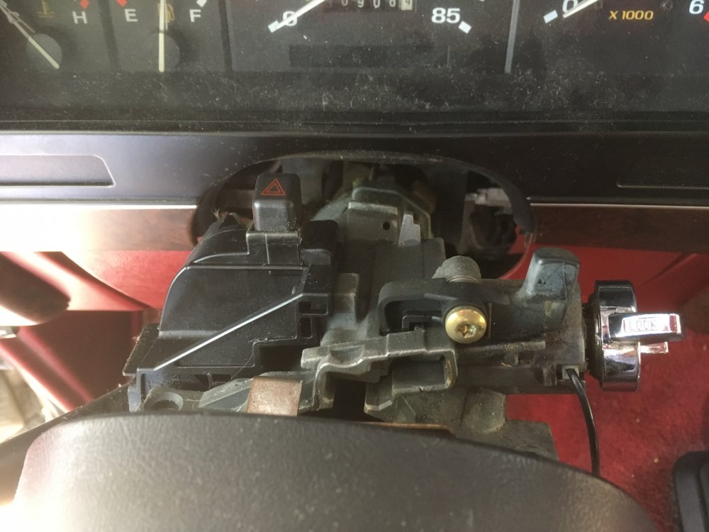

Thanks Paulo..I found it. It's right inside the dash directly on top of the column, below the speedometer and gauge assembly. Looks like a pretty crummy spot to put it, not easily accessible by any means. I'm going to try other options at this point, before I try getting to that switch.

If the battery was connected when it went dead (I'm assuming), I would definitely check the starter switch. I know it's a pain to get to, but it sounds like you've got a short somewhere, and that would be a good thing to check off of your troubleshooting list. At least you would know either way. Like I said before, I have seen the switches start to come apart, and as a temporary fix you can squeeze the metal tabs on the corners to pull it back together. If you pull the switch out and it comes apart in the process, you'll know.
