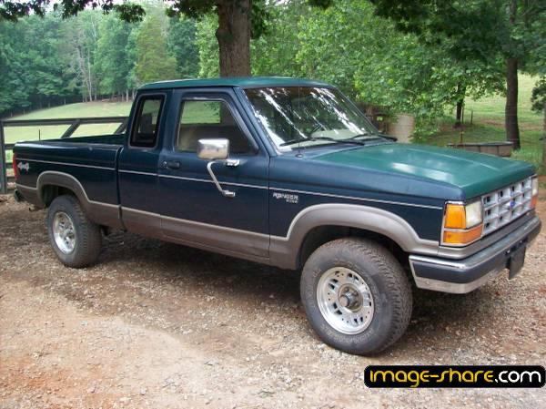

Link to picture of my truck (havnt figured out how to post pics yet)
