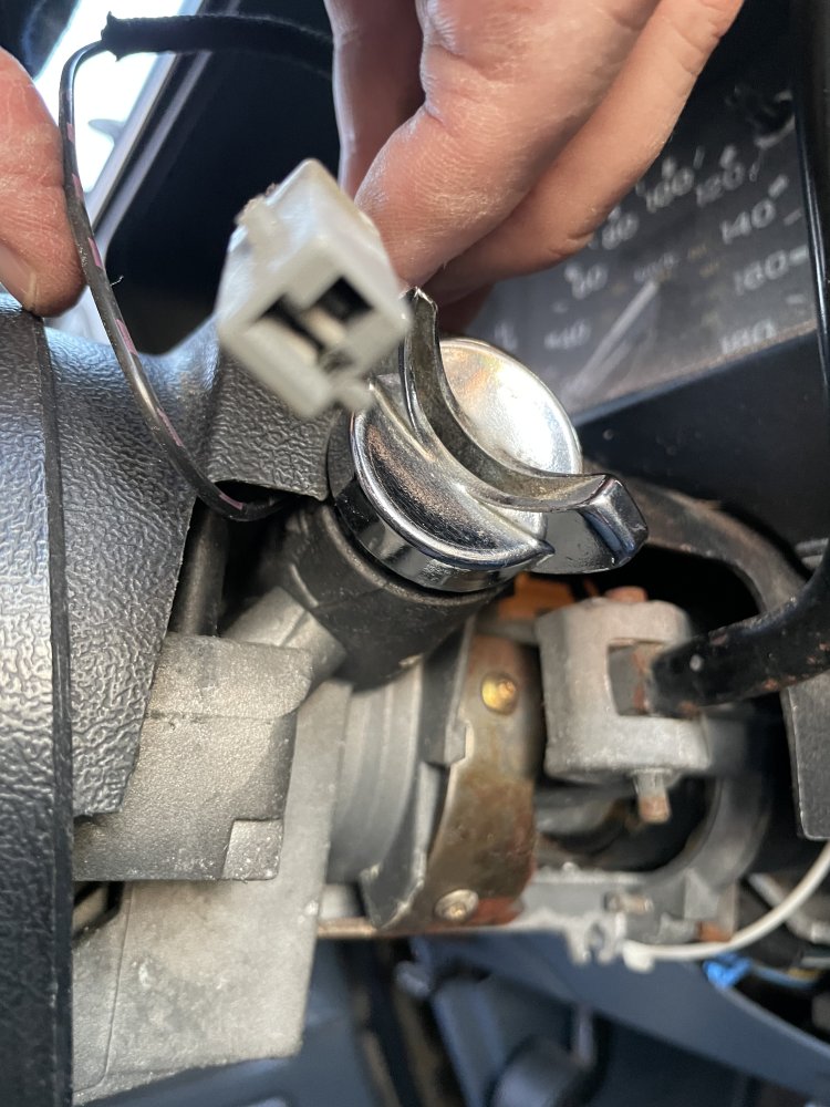

As I pulled apart the plastic under the steeringcolumn a wire fell out. Had to run so didn’t check it more today. What does it do?

Any ideas about the cable under the steeringwheel featured in the picture?
