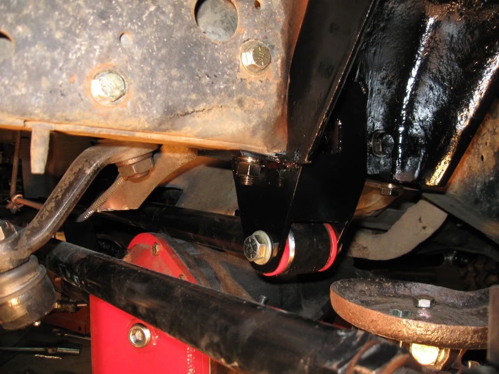

all of that aside, you're argument about the trac bar mount is over burdened with fallecies. It doesnt matter if you use 1/4 or 3/8... I seen the picture of your welder... trust me... its not penetrating the 3/8 any better than the 1/4.
Your new mount is neither stronger, nor improved by any significant value.... it is heavier though...:icon_thumby:
Secondly, the picture of Nobody's old truck is either missing, or you cannot see that he ran a brace from the trac-bar mount, to the engine x-member, although even without that brace, the way it is mounted, spec wise... does distribute the load different and better than your mount.
moving on to greener pastures.... the city called, they want their stop sign post back.... come on man, that shit is janky. Did you really butt-weld that 90* without any sort of gusseting? You sir, are braver than I.

This thread kills me. First off, props for doing the work and building what you want. Doing the work is how you learn. The problem is, you're not learning. A previous design failed and you built a similar part, just with thicker material.
The reason there's so much discussion on trac bars is because its a CRUTIAL component of your suspension. Why be so hard headed, take what these guys say with an open mind and you may be able to learn something.
Thicker isn't always better. I guess I'd better post my setup so you can judge my credibility.
89 Linked Ranger Build (LOTS of pics)
Better wait till you get through some 3-400 level ME courses before claiming to be an ME major. Taking a few Gen Ed courses and falsely argueing Strength of Materials concepts makes us look bad :thefinger:

Merry Christmas to you too. But, as for the rest of your reply.... I'm not going to bother replying too much, since it's wasting my time. I believe I've said it numerous times now, it was a temporary quick fix, out in the bush. The engine is out of the truck now, and something new is being put in there, as well as a new front suspension. The least of our worries is that front trac bar mount.

We learned a lot.... The first one failed, under some medium abuse. We built a new one, and it has held up great to all the rest of the abuse throughout the summer (which was harder wheeling than the beginning of the season when the first one failed). And now, whether you think it's too weak or not, it does not matter, cause the truck will not be ran with that front axle anymore.
