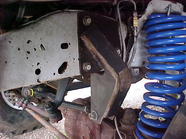

Here's a decent example of a home-brew track bar mount that "Nobody" built several years ago (It's in our own Tech Library):
89 Linked Ranger Build (LOTS of pics)
Notice how much of the plate is consumed by the mount and it's gusseting? That helps distribute the load to all three steering box bolts, as well as through the two vertical bolts mounted underneath the frame. I'm not sure why there is a large gap in there, I would leave that out and weld completely around the corner of the frame. Many people also build a support arm to tie this mount back into the engine crossmember for extra insurance.
