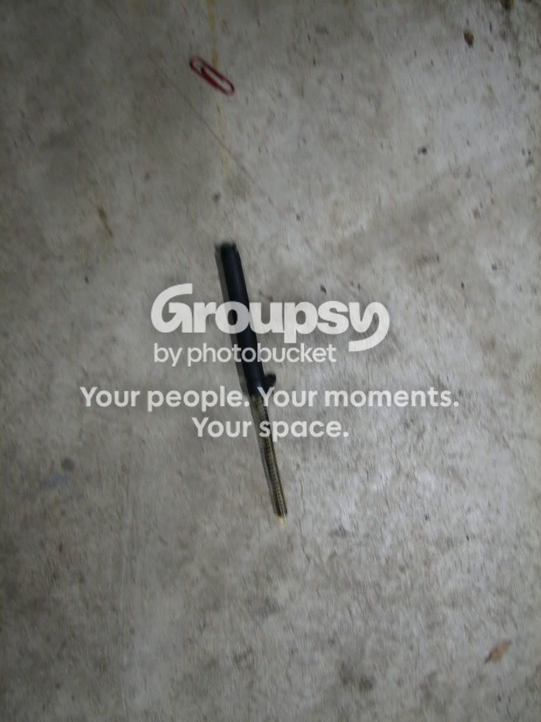

I recently picked up a new pin, but it doesn't fit. What I bought looks like what robbied described, but whats in the truck doesn't. This is the "pin" that i pulled out
It appears to be from a different vehicle. It has a long spring in it and tab to push a switch. The pin was broken, but I don't even see any wiring going to the "sleeve" it resides in.
This is a pic from inside the truck. The pin sleeve is mounted to the seatbelt spool thing.

Aww, man, I hate telling you this, but you're barking up the wrong tree. The dome light pin switch is on the front door jamb. What's in the pictures is the comfort regulator release switch for the seat belts, that's in the rear jamb. Just put that back together (at least it was already broke, right?), and look at the front jamb. I'm sorry that you got turned around on it.
