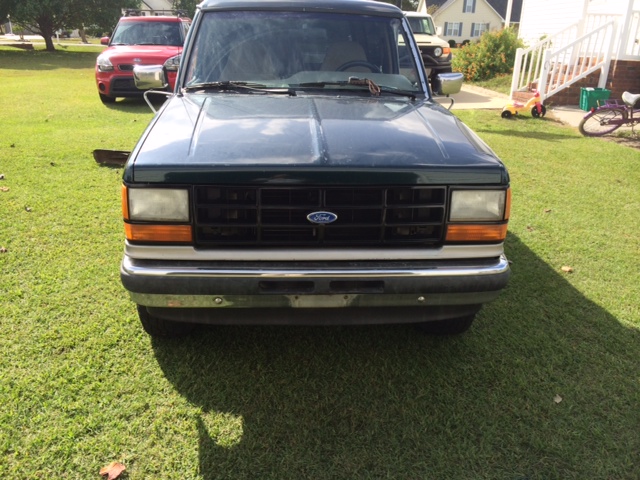

Got my B2 a while back and making steady progress. Here are a few pics of the progression.
the starting platform

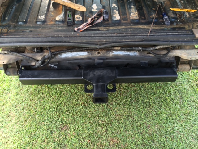

started with minor stuff. The grill needed paint and a hitch and rear bumper was a must

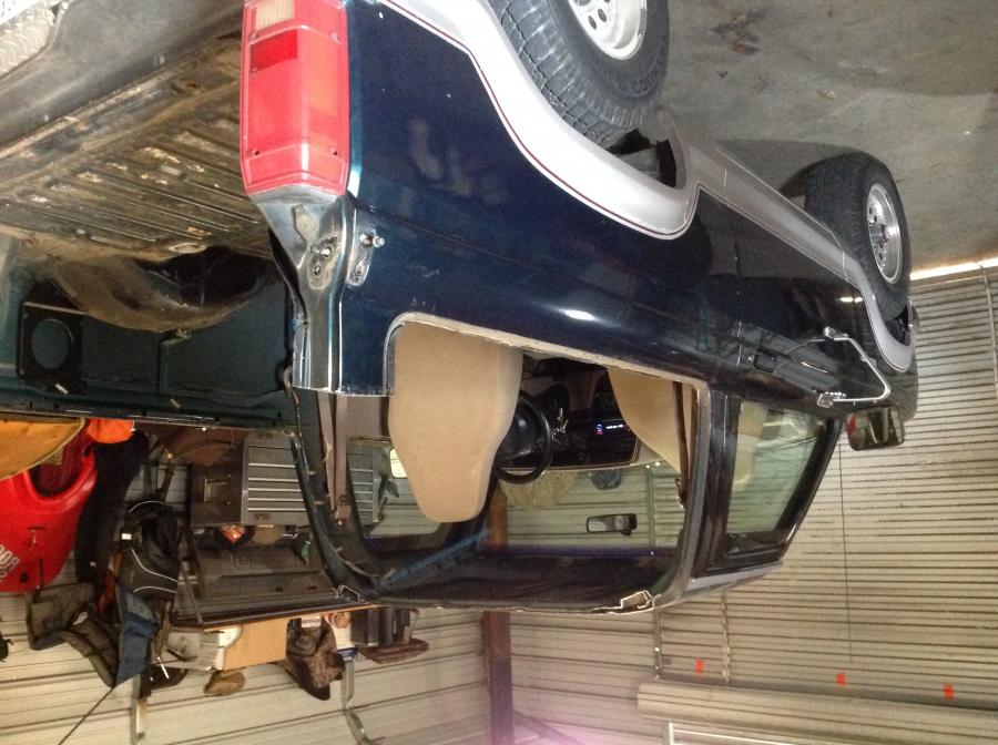

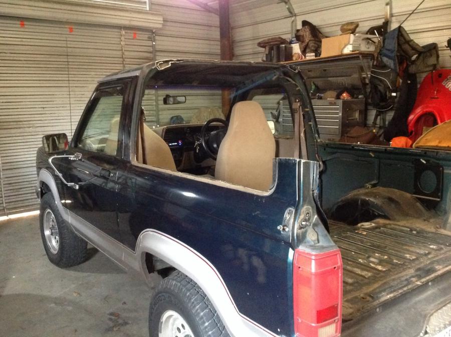

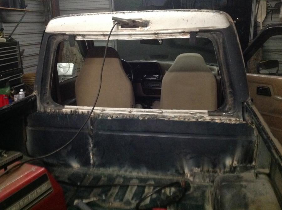

Now why I wanted a B2 in the first place........ chop the top
Ok, I had a B2 in the past with an open top and hated being limited by bad weather. so this time I wanted to do a half cab version.
I wanted to be able to weld in the cab so I got a rear hatch off an explorer and mated it to the cab of the bronco.

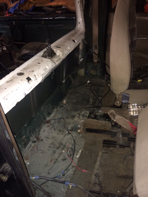

I used the sheet metal from the chopped top to finish off the bottom below the window and get the fit I wanted.
The other nice thing about this is the rear window opens and a couple of screws, it come off and the cab is almost as open as the last chop job.
The interior mostly finished. Still need to get a molding for the hatch. The one I had got broken laying around in my shop.

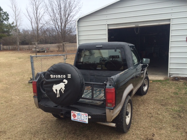

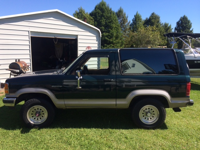

kinda finished product so far.

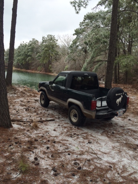

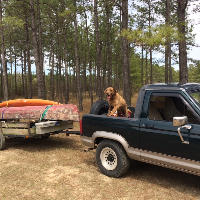

forgot to attach the pics
