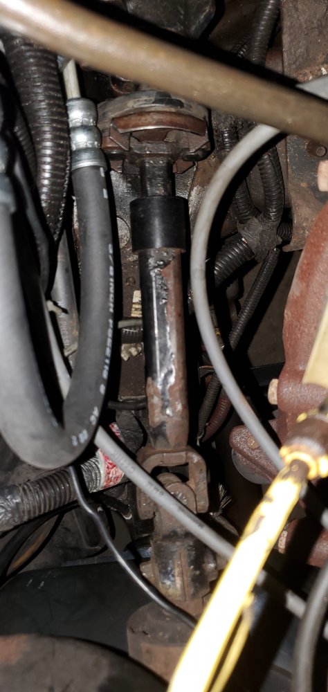

Here is the deal oh wise 4x4 Ford guru-types: What is going on with my steering shaft? Below there is a picture of it. Is there suppose to be a rag joint in there? Looks to me like there isn't one. Also I am having a bit of trouble finding a new U-Joint if anyone can point me in the right direction.

Buying a Borgeson with U-joints on both ends. Problem solved
