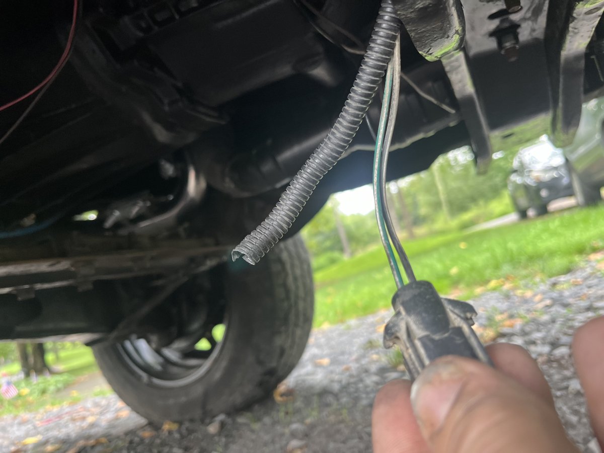

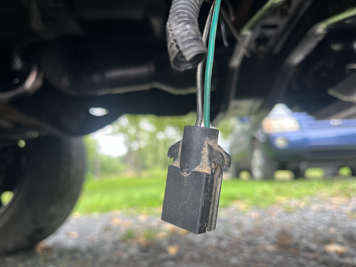

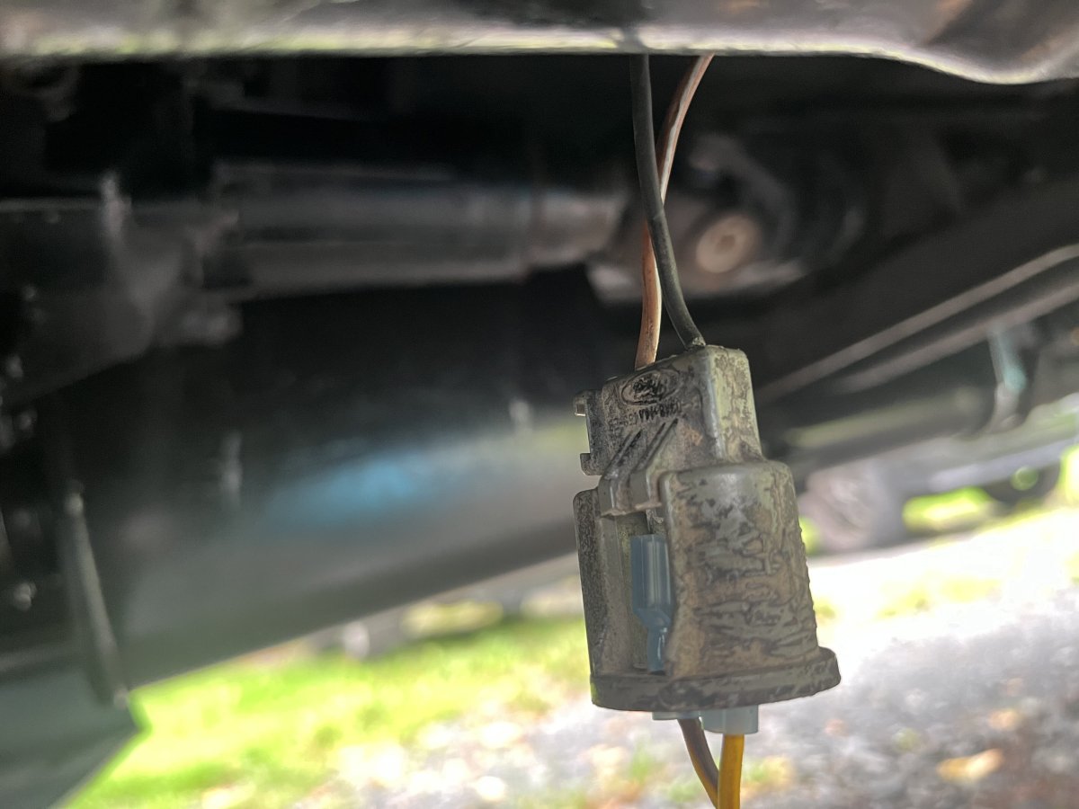

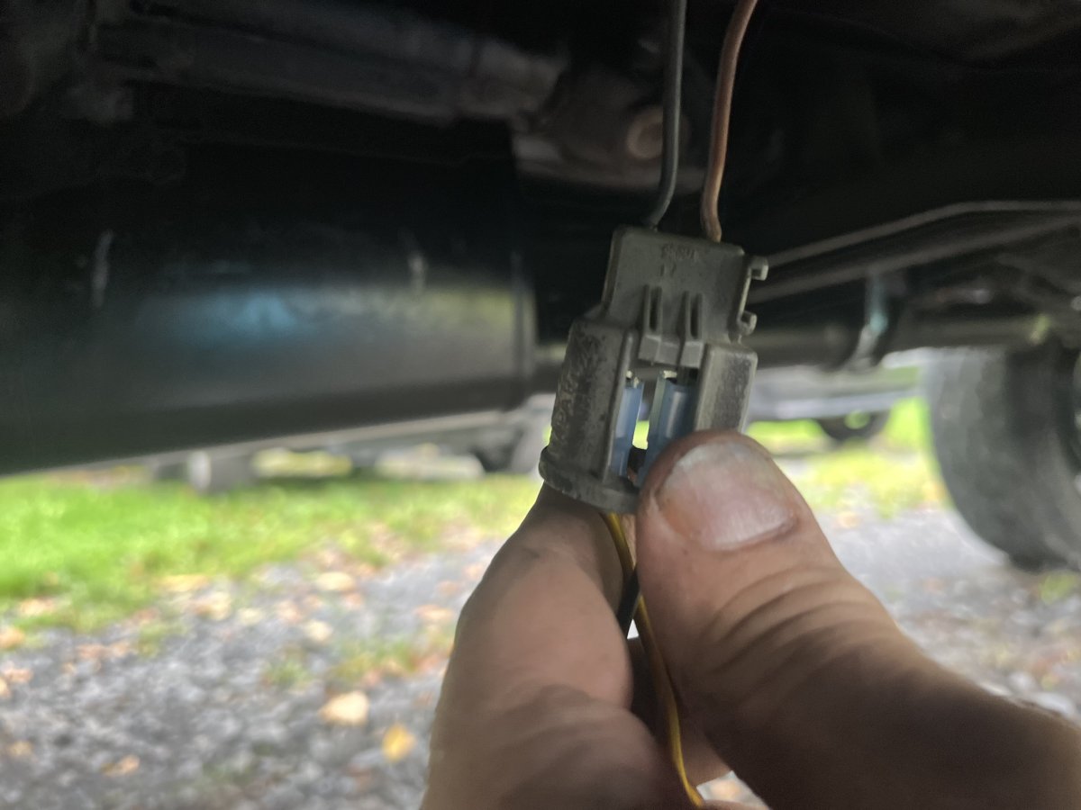

Here are the two connectors that I have not identified yet: (The third I have identified: it is to the in-tank pusher fuel pump)
First 2 photos- conncetor 1- seems to have a Tan/White or very faded orange/white and a solid black wire
Photos 3 &4 - seems to have a green/white and a black/white wire
