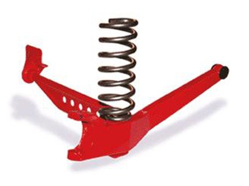

Autofab(?) has there bent beam kit for a lot less then 2k. Chassisteck isn't even that much if they still make them. Still in the end the beams won't give be further from the ground until you put taller tires on in my opinion. Here in Wisconsin I get buy on my 2wd with the spacer lift and 235/75r15s very well.
TapaTapaTapa
The airbagit.com beams 900 bucks
TapaTapaTapa
You already have forged beams, so just use those. I bet most off road shops would bend them for you.
